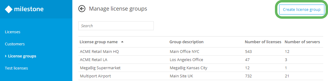

  1. Log in to Milestone Customer Dashboard (https://online.milestonesys.com/).
  2. In the main menu, select License groups.
  3. Select Create license group.

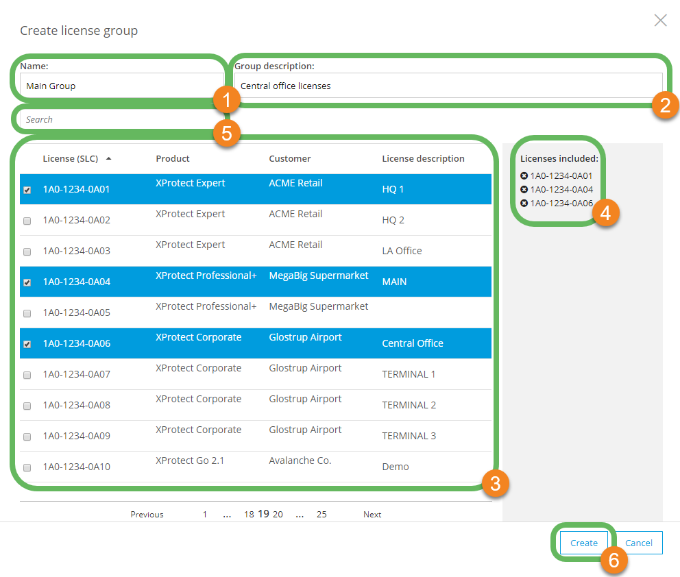

  4. In the Create license group dialog box:
    1. In the Name field, enter a name for the license group.
    2. Optional: In the Group Description field, enter a description of the group.
    3. In the main section of the dialog , select licenses that you want to add to the group. Remove added licenses from the right-hand side of the dialog , or by selecting them again in the main section.
    4. Optional: in the Search field, search by license, product, customer, or description.
    5. Select Create .

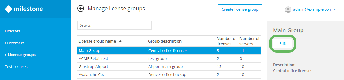

Edit or delete a license group
  1. Select an existing license group and select Edit.
  2. In the Edit license group dialog box, you can edit the name and description of the license group and add or remove licenses in the group.
  3. Select Save to save your changes.
  4. Alternatively, select Delete to delete the license group.
