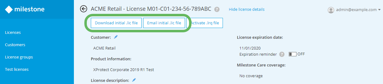

Get a software license (.lic) file in Milestone Customer Dashboard
If a software license code (SLC) is registered in Milestone Customer Dashboard, you can get the associated software license (.lic) file that is used when installing a VMS system.
To get a software license (.lic) file:
  1. Log in to Milestone Customer Dashboard (https://online.milestonesys.com/).
  2. Select Customers or Licenses in the main menu.
  3. On the Customers tab, double-click a customer, then double-click an associated License (SLC). Alternatively, double-click an SLC on the Licenses tab.
  4. Select Download initial .lic file to download the license file directly, or select Email initial .lic file to open the Email initial license file dialog to send an email containing the license file to one or more recipients.

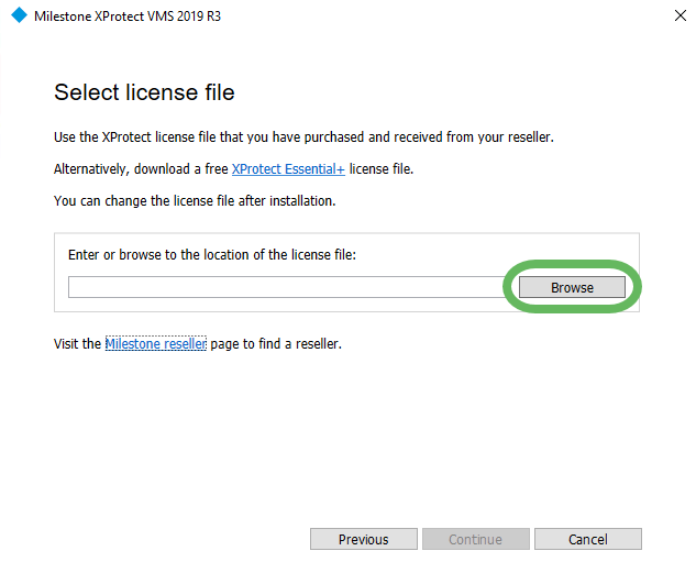

To import a software license (.lic) file:
  1. Find the downloaded license file on your computer. Alternatively, find the email with the software license file attached and copy the license file to your computer.
  2. Run the Система управления видео XProtect product installer.
  3. In the Select license file window, select Browse, locate the software license file, then select Continue.

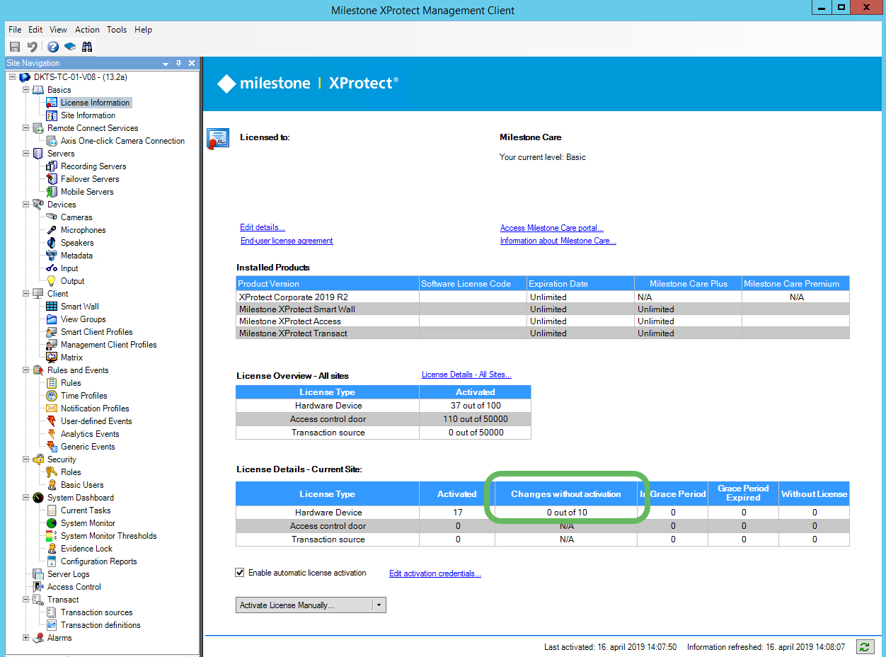

About the grace period and changes without activation
After the system is licensed using a license (.lic) file, you can add devices and use them for 30 days without activating hardware device licenses for them. To continue to use the devices after 30 days, you must activate the hardware device licenses.
You can change a certain number of cameras without having to activate device licenses again, called Changes without activation. The number of changes that you can make is refreshed annually and is based on usage conditions, such as your Система управления видео XProtect product and the number of device licenses that you have purchased.
See the current list of variable values on the Milestone device calculation web page (https://www.milestonesys.com/device-change-calculation/). You can learn more about changes without activation in the Management Client help system.
To view your changes without activation:
  1. Open Management Client.
  2. Select License Information.
  3. In the License Details - Current Site section, the number is shown under Changes without activation.

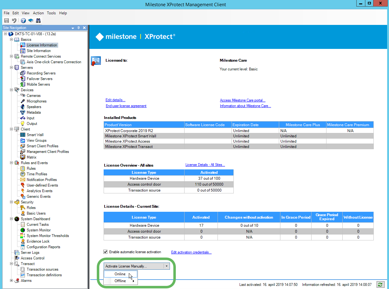

Start online activation manually
  1. In Management Client, in the Site Navigation pane, expand Basics, and select License Information.
  2. Select Activate License Manually, then select Online.
  3. Enter the user name and password for your (Undefined variable: Variables.MyMil) account, then select Next.
  4. Select Finish to activate the licenses.

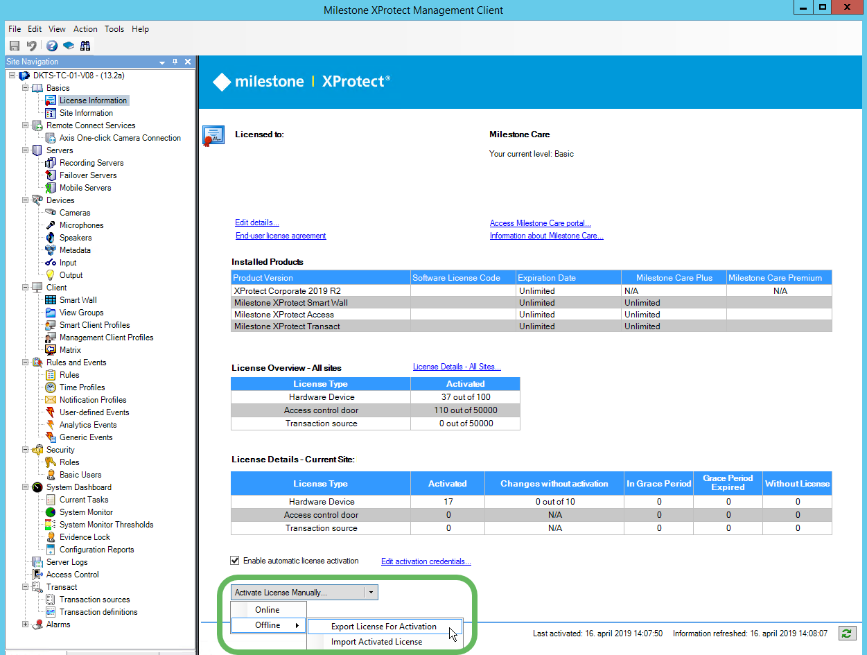

Export a license request (.lrq) file from Management Client
The license request file contains information about your Система управления видео XProtect system. For example, it contains the number of hardware devices for which to activate licenses.
To export a license request (.lrq) file:
  2. At the bottom left-hand side of the main workspace, select Activate License Manually > Offline > Export License For Activation.
  3. Save the license request (.lrq) file to a portable storage device.

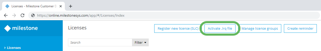

Activate a license request (.lrq) file in Milestone Customer Dashboard
  1. Log in to Milestone Customer Dashboard.
  2. Select Customers & Licenses, then select Activate .lrq file.
  3. Select Activate .lrq file, and then find the license request (.lrq) file that you saved on the portable storage device.
  4. Optional: By default, the activated license file is sent to the email address that was specified when the software license was purchased. To add more email recipients for the activated license file, enter the recipients' email addresses in the Enter additional recipients (optional) field and select Add.
  5. Select Upload.
