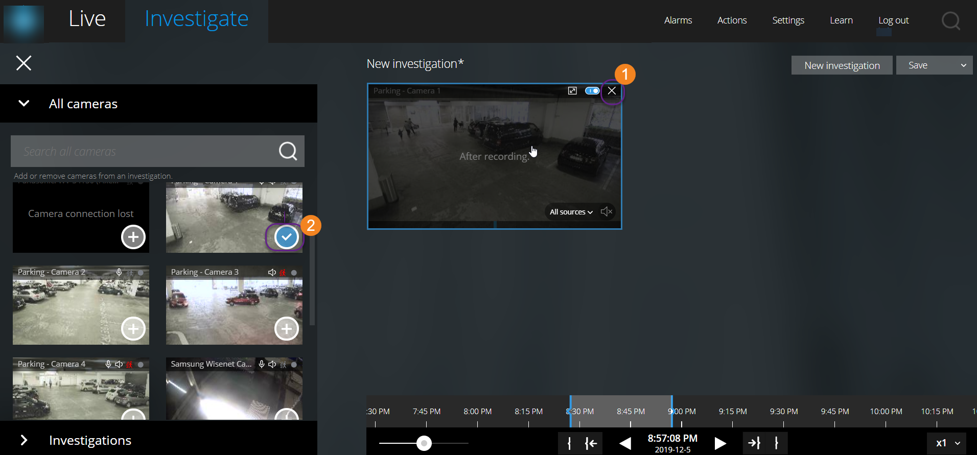

"Before I play back the video, I want to remove the cameras that don’t have any recordings within the time span that I’ve specified. How can I do that?"
On the Investigate tab, you can remove the unnecessary cameras from a camera group if you:
  • Hover over the camera and then, in the upper right-hand corner, click
  • On the side panel, click
  • On the side panel, double-click the camera that you want to remove
