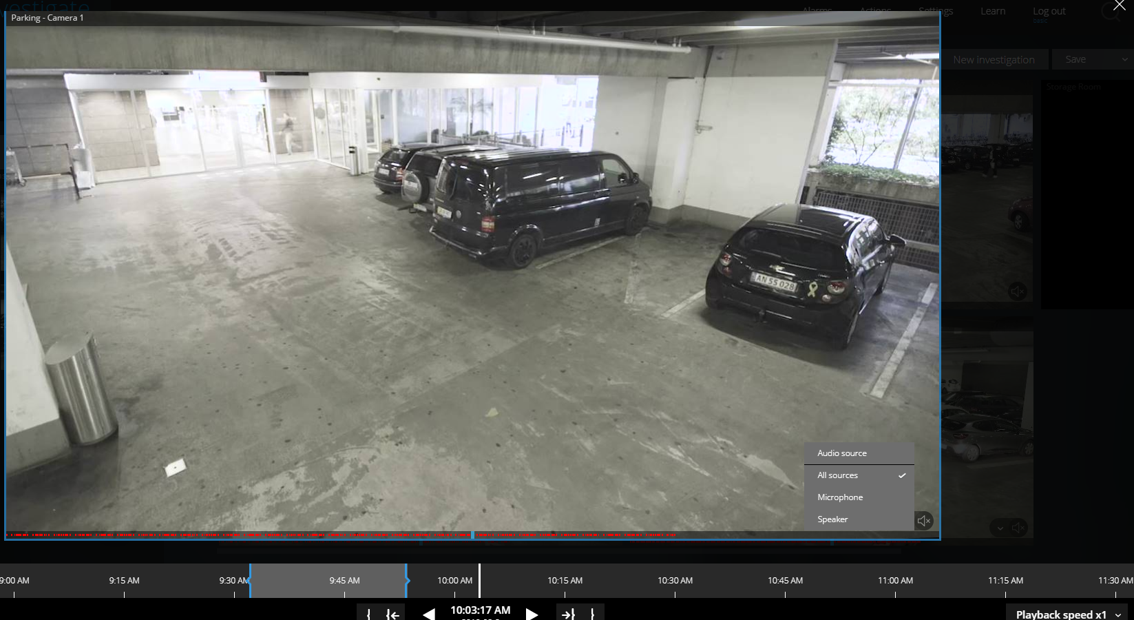

  • To listen to recorded incoming audio, click to start playing the audio while playing back the video recording
  • To listen to recorded incoming audio and outgoing audio, click to start playing the audio. From the Audio source list, select the audio device that you want to listen to while playing back the video recording. The options are:
    • All sources (default) - listen both to the recorded incoming and outgoing audio
    • Microphone - listen to the incoming audio only
    • Speaker - listen to the outgoing audio only
You can play back audio only when there is a video recording and you play the recording forward at normal speed.
