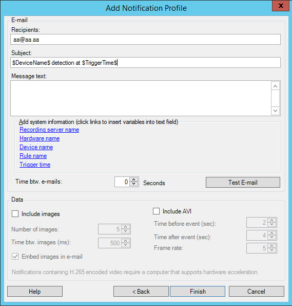

- Notification profiles: You can use notification profiles to set up ready-made email notifications, which can automatically be triggered by a rule, for example when a particular event occurs

| Send notification to <profile> |
Sends a notification, using a particular notification profile. When you select this type of action, the Manage Rule wizard prompts you to select a notification profile, and which devices to include pre-alarm images from. You can only select one notification profile and you cannot select several notification profiles. A single notification profile may contain several recipients. You can also create more rules to the same event and send different notifications to each of the notification profiles. You can copy and re-use the content of rules by right-clicking a rule in the Rules list. This type of action requires that you have defined at least one notification profile. Pre-alarm images are only included if you have enabled the Include images option for the relevant notification profile. No mandatory stop action: This type of action does not require a stop action.You can specify optional stop actions to be performed on either an event or after a period of time. |

- Expand Rules and Events, right-click Notification Profiles > Add Notification Profile. This opens the Add Notification Profile wizard.
- Specify name and description. Click Next.
- Specify recipient, subject, message text and time between emails:
- To send a test email notification to the specified recipients, click Test E-mail.
- To include pre-alarm still images, select Include images, and specify number of images, time between images and whether to embed images in emails or not.
- To include AVI video clips, select Include AVI, and specify the time before and after event and frame rate.
- Click Finish.

Notification profile (properties)
Specify the following properties for notification profiles:
Component |
Requirement |
| Name |
Enter a descriptive name for the notification profile. The name appears later whenever you select the notification profile during the process of creating a rule. |
| Description (optional) |
Enter a description of the notification profile. The description appears when you pause your mouse pointer over the notification profile in the Overview pane's Notification Profiles list. |
| Recipients |
Enter the e-mail addresses to which the notification profile's e-mail notifications should be sent. To enter more than one e-mail address, separate addresses with a semicolon. Example: aa@aaaa.aa;bb@bbbb.bb;cc@cccc.cc |
| Subject |
Enter the text you want to appear as the subject of the e-mail notification. |
| Message text |
Enter the text you want to appear in the body of the e-mail notifications. In addition to the message text, the body of each e-mail notification automatically contains this information:
| Time between e-mails |
Specify required minimum time (in seconds) to pass between the sending of each e-mail notification. Examples:
| Number of images |
Specify the maximum number of still images you want to include in each of the notification profile's e-mail notifications. Default is five images. |
| Time between images (ms) |
Specify the number of milliseconds you want between the recordings presented on the included images. Example: With the default value of 500 milliseconds, the included images show recordings with half a second between them. |
| Time before event (sec.) |
This setting is used to specify the start of the AVI file. By default, the AVI file contains recordings from 2 seconds before the notification profile is triggered. You can change this to the number of seconds you require. |
| Time after event (sec.) |
This setting is used to specify the end of the AVI file. By default, the AVI file ends 4 seconds after the notification profile is triggered. You can change this to the number of seconds you require. |
| Frame rate |
Specify the number of frames per second you want the AVI file to contain. Default is five frames per second. The higher the frame rate, the higher the image quality and AVI file size. |
| Embed images in e-mail |
If selected (default), images are inserted in the body of e-mail notifications. If not, images are included in e-mail notifications as attached files. |
