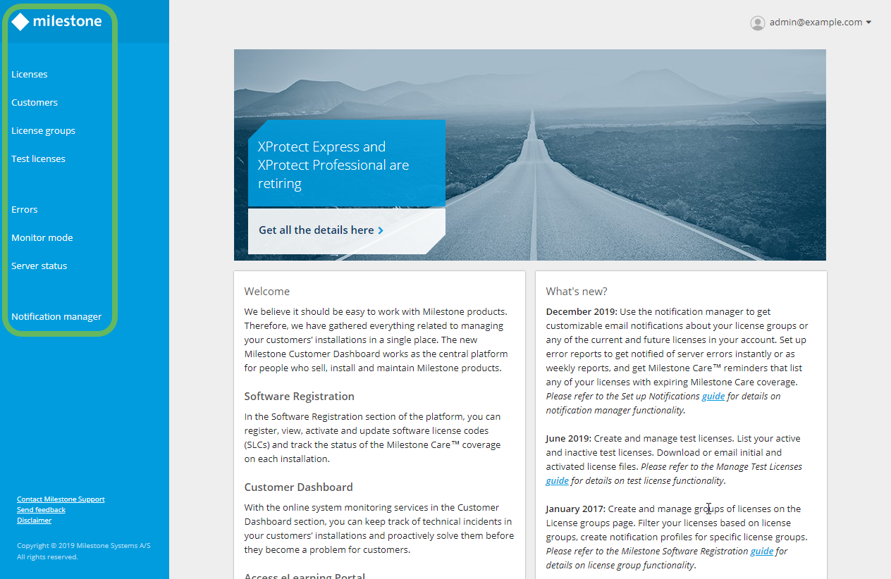

Navigating the site
You can navigate Milestone Customer Dashboard using the main menu on the left-hand side of the interface.
If you have the License user role, some functionality may not be available. For more information about user roles, see Giving users access to Milestone Customer Dashboard.
Menu items |
Description |
Milestone logo |
Return to the Milestone Customer Dashboard main page. |
Licenses |
See a list of licenses associated with your account, as well as options related to license management. For more information about licenses, see Licenses in Milestone Customer Dashboard (explained). |
Customers |
See a list of customers that you have created, including the number of licenses and servers associated with each customer. For more information about customers, see Customers in Milestone Customer Dashboard (explained). |
License groups |
Create, edit, or delete license groups or search for a specific license group. License groups are used for receiving error notifications from groups of systems. For more information about license groups, see Grouping licenses. |
Test licenses |
Manage test licenses, which are used for demonstration and training purposes of XProtect VMS installations. For more information about test licenses, see Managing test licenses. |
Errors |
Keep track of technical incidents in your customers’ installations. |
Monitor mode |
See the status messages of any of the systems that you monitor for your customers. |
Server status |
See if a server is monitored by Milestone Customer Dashboard, and the current error state of the server. You can search for and filter for servers and error states, and you can also create PDF reports about servers that you select. |
Notification manager |
Manage customizable emails that report the errors of a given server and the status of the Milestone Care™ coverage of your licenses. For more on managing notifications, see Notification manager (explained). |
