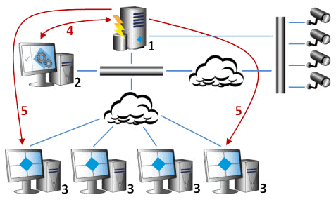

Legend:
- Surveillance system
- Management Client
- XProtect Smart Client
- Alarm configuration
- Alarm data flow
