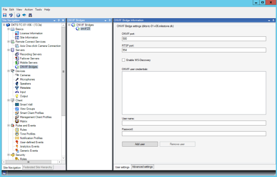

Open the Management Client and select the ONVIF Bridges node.
User settings tab (properties)
The following table describes the settings for the ONVIF Bridge server and ONVIF clients.
Name |
Description |
ONVIF port |
The port number of the ONVIF port. ONVIF clients use this port to connect to the ONVIF Bridge server. The default port number is 580. |
RTSP port |
The port number of the RTSP port. The ONVIF Bridge server sends RTSP video streams through this port to ONVIF clients. The default port number is 554. |
WS-Discovery |
WS-Discovery ( Web Services Dynamic Discovery) is a technical specification that defines a multicast discovery protocol to locate services on a local network. For this setting to take effect, ONVIF Bridge server must be restarted. |
ONVIF user credentials |
Lists the ONVIF client users that have access to the XProtect VMS system through the ONVIF Bridge server. |
User name |
The domain user name of the user created for an ONVIF client. Requirement: You must set up the ONVIF client users as users in Management Client with access to cameras and the Milestone ONVIF Bridge. |
Password |
The password for the ONVIF client user. |
Add user |
After you enter a domain user name and password, click the Add user button to add the user. |
Remove user |
Prevent an ONVIF client from accessing the Milestone ONVIF Bridge. Remove a selected user from the ONVIF user credentials list. |
