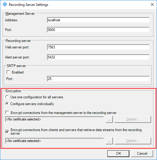

- On the computer that runs the recording server, right-click the Recording Server Manager icon in the notification area.
- Select Stop Recording Server service.
- Right-click the Recording Server Manager icon again and select Change Settings.
The Recording Server Settings window appears.
- At the bottom, specify encryption settings for the recording server:
- Encrypt connections from clients and servers that retrieve data streams from the recording server: Before you enable encryption, read the requirements listed in this topic
- Select a certificate: Contains a list of unique subject names of certificates installed on the local computer in the Windows Certificate Store that has a private key.
The recording server service user has been given access to the private key. It is required that this certificate is trusted on all clients.
- Details: Click to view Windows Certificate Store information about the selected certificate
- Click OK.
- To start the Recording Server service again, right-click the Recording Server icon and select Start Recording Server service.

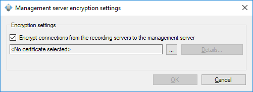

- On the computer that runs the management server, right-click the Management Server Manager icon in the notification area.
- Select Management Server service.
- Right-click the Management Server Manager icon again and select Change encryption settings.
The Management server encryption settings window appears.
- Specify encryption settings for the recording server:
- Encrypt connections from the recording servers to the management server: Before you enable encryption, read the requirements listed in this topic
- Select a certificate: Contains a list of unique subject names of certificates installed on the local computer in the Windows Certificate Store that has a private key, and the CA certificate must be trusted on the management server.
- Click OK.
- To start the Management Server service again, right-click the Management Server Manager icon and select Start Management Server service.
To complete the enabling of encryption, next step is to update the encryption settings on each recording server. For more information, see Enable encryption from the management server.

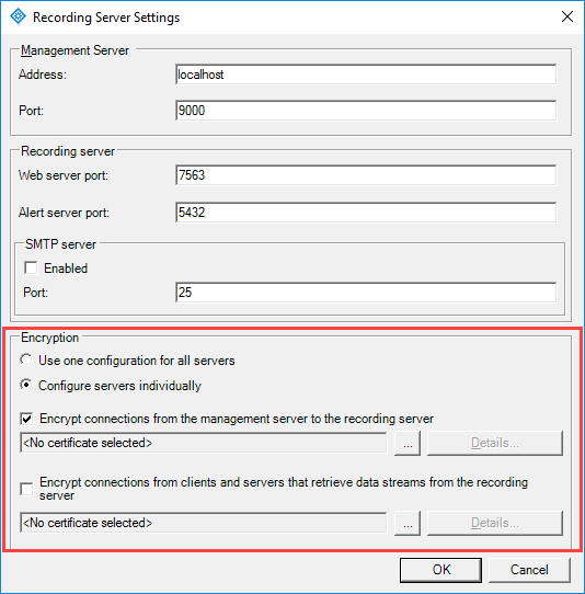

- Encrypt connections from the management server to the recording server: Before you enable encryption, read the requirements listed in this topic
- You can select the Use one configuration for all server option, if you use the same certificate on all the servers.
- Click OK.
- In the Register on the management server dialog box, enter the address of the management server that you want the recording server to connect to and click OK. Default port number is 443.
- Enter the user name and password of a system administrator of XProtect and click OK.
