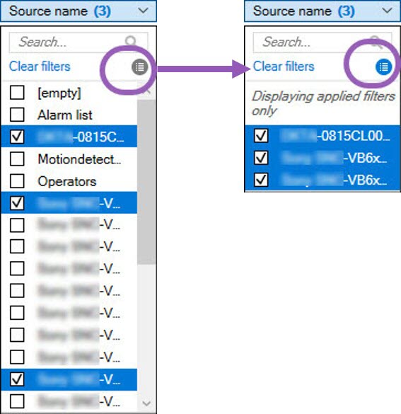

Under the tabs, select a filter group, for example, Category, Source type, or User.
A list of filters appears.
Select a filter to apply it. Select the filter again to remove it.
Optional: In a list of filters, select Display applied filters only to see only the filters that you applied.
The contents of your export change depending on the filters that you apply. For information about your export, see Export logs.

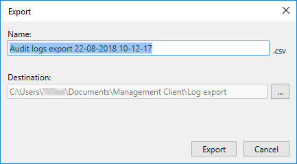

Exporting logs helps you to, for example, save log entries beyond the log retention period. You can export logs as comma-separated values (.csv) files.
To export a log:
Select Export in the upper-right corner. The Export window appears.
In the Export window, in the Name field, specify a name for the log file.
By default, exported log files are saved in your Log export folder. To specify a different location, select
to the right of the Destination field. -
Select Export to export the log.
The contents of your export change depending on the filters that you apply. For information about your export, see Filter logs.
