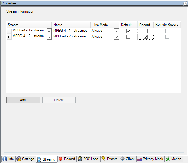

Streams tab (devices)
Streams tab (explained)
The following devices have a Streams tab:
- Cameras
The Streams tab lists by default a single stream. It is the selected camera's default stream, used for live and recorded video.
For live streaming, you can set up and use as many live streams as the camera supports, but you can only select one stream for recording at a time. To change which stream to use for recording, select the Record box for the stream to be recorded.
Multi-streaming (explained)
Viewing live video and playing back recorded video do not necessarily require the same video quality and frame rate. You can have either one stream for live viewing and another stream for playback purposes or multiple separate live streams with different resolution, encoding, and frame rate settings.
To manage streaming and limit unnecessary data transmission, streaming does not start when the following conditions are met:
- On the Streams tab, Live Mode is set to When needed
- On the Record tab, Recording is disabled
- On the Motion tab, Motion detection is disabled
If these conditions are met, video streams will only run when viewed by a client.
Example 1, live and recorded video:
- For viewing live video, your organization may prefer H.264 at a high frame rate
- For playing back recorded video, your organization may prefer MJPEG at a lower frame rate to preserve disk space
Example 2, local and remote live video:
- For viewing live video from a local connected operating point, your organization may prefer H.264 at a high frame rate to have the highest quality of video available
- For viewing live video from a remotely connected operating point, your organization may prefer MJPEG at a lower frame rate and quality to preserve network bandwidth
Example 3, adaptive streaming:
- For viewing live video and decreasing the load on the CPU and GPU of the XProtect Smart Client computer, your organization may prefer multiple high frame rate H.264/H.265 but with different resolutions to match the resolution requested by XProtect Smart Client when using adaptive streaming. For more information, see Smart Client profile properties.
If you enable Live multicast on the camera's Client tab, it only works on the default video stream.
Even when cameras support multi-streaming, individual multi-streaming capabilities may vary between different cameras. See the camera's documentation for more information.
To see if a camera offers different types of streams, see the Settings tab.
Add a stream
- On the Streams tab, click Add. This adds a second stream to the list.
- In the Name column, edit the name of the stream. The name appears in XProtect Smart Client.
- In the Live Mode column, select when live streaming is needed:
- Always: the stream runs even if no XProtect Smart Client users request the stream
- Never: the stream is off. Only use this for recording streams, for example, if you want recordings in high quality and need the bandwidth
- When needed: the stream starts when a user of XProtect Smart Client requests for it
- In the Default column, select which stream is default.
- In the Record column, select the check box if you want to record this stream or leave it cleared if you only want to use it for live video.
- Click Save.
If you set a stream to Default or Record, the stream is always running independent of the Live Mode setting. Selecting When needed and Always have the same effect in the system and if you select Never, the stream is running, but cannot be viewed live.
If you do not want the streams to run at all unless someone is viewing live video, you can modify the Default Start Feed Rule to start on request with the predefined Live Client Feed Requested event.

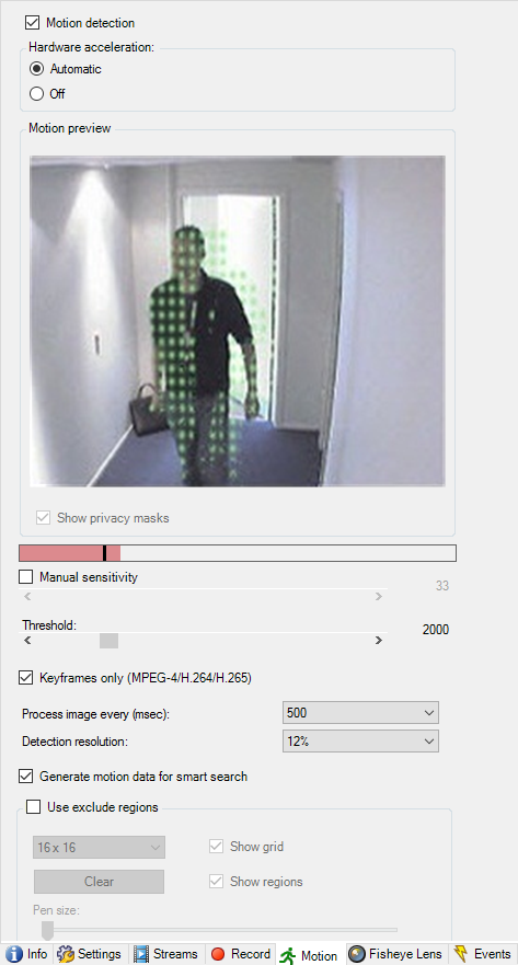

Enable manual sensitivity
The sensitivity setting determines how much each pixel in the image must change before it is regarded as motion.
- Select the Motion tab's Manual Sensitivity check box.
- Drag the slider to the left for a higher sensitivity level, and to the right for a lower sensitivity level.
The higher the sensitivity level, the less change is allowed in each pixel before it is regarded as motion.
The lower the sensitivity level, the more change in each pixel is allowed before it is regarded as motion.
Pixels in which motion is detected are highlighted in green in the preview image.
- Select a slider position in which only detections you consider motion are highlighted.
You can compare and set the exact sensitivity setting between cameras by the number in the right side of the slider.
Specify threshold
The motion detection threshold determines how many pixels in the image must change before it is regarded as motion.
- Drag the slider to the left for a higher motion level, and to the right for a lower motion level.
- Select a slider position in which only detections that you consider motion are detected.
The black vertical line in the motion indication bar shows the motion detection threshold: When detected motion is above the selected detection threshold level, the bar changes color from green to red, indicating a positive detection.
Motion indication bar: changes color from green to red when above the threshold, indicating a positive motion detection.

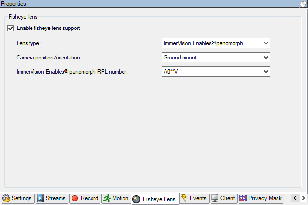

On the Fisheye Lens tab, you can enable and configure fisheye lens support for the selected camera.
Enable and disable fisheye lens support
The fisheye lens support is disabled by default.
To enable or disable it, select or clear the Fisheye Lens tab's Enable fisheye lens support check box.
Specify fisheye lens settings
When you enable the fisheye lens support:
- Select the lens type.
- Specify the physical position/orientation of the camera from the Camera position/orientation list.
- Select a Registered Panomorph Lens (RPL) number from the ImmerVision Enables® panomorph RPL number list.
This ensures the identification and correct configuration of the lens used with the camera. You usually find the RPL number on the lens itself or on the box it came in. For details of ImmerVision, panomorph lenses, and RPLs, see the Immervision website (https://www.immervisionenables.com/).

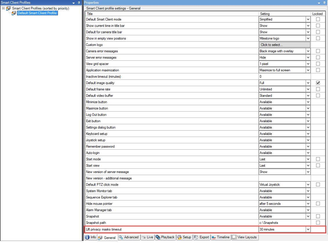

Change the timeout for lifted privacy masks
By default, privacy masks are lifted for 30 minutes in XProtect Smart Client and afterwards applied automatically, but you can change that.
When you change the timeout, remember to do it for the Smart Client profile associated with the role that has the permission to lift privacy masks.
To change the timeout:
- Under Smart Client Profiles, select the relevant Smart Client profile.
- On the General tab, locate Lift privacy masks timeout.
- Select between the values:
- 2 minutes
- 10 minutes
- 30 minutes
- 1 hour
- 2 hours
- Until logged out
- Click Save.

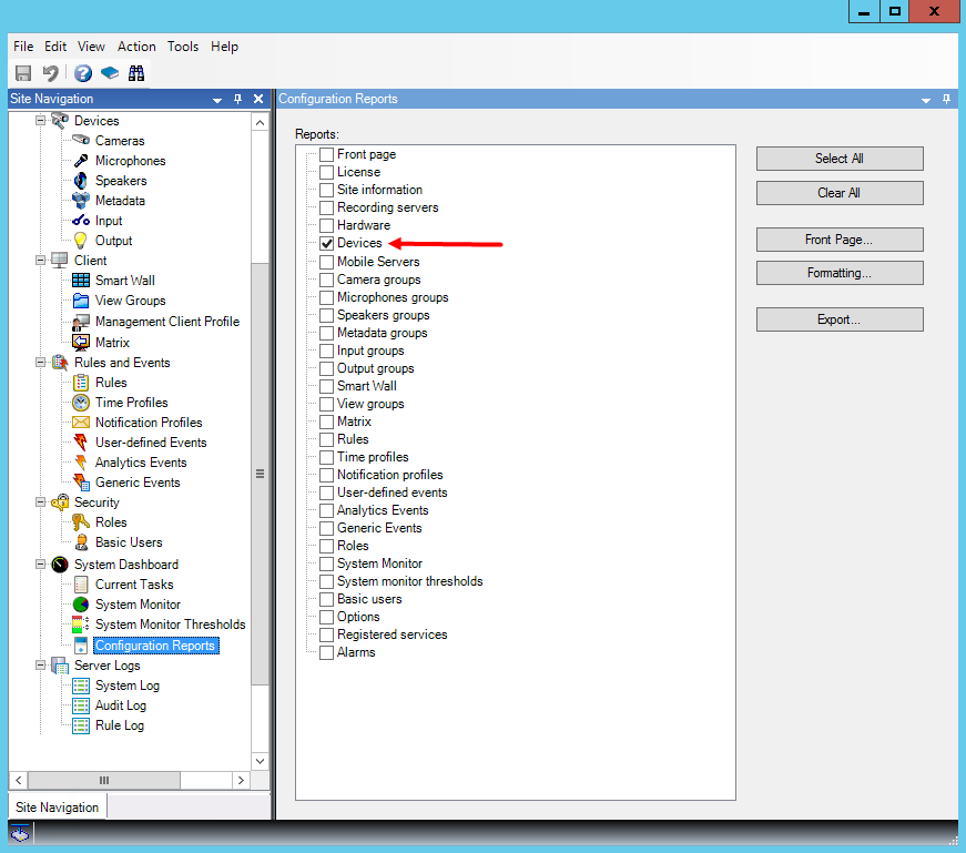

Create a report of your privacy masking configuration
The devices report include information about your cameras' current privacy masking settings.
To configure a report:
- Under Configuration Reports, select the Devices report.
- If you want to modify the report, you can change the front page and the formatting.
- Click Export, and the system creates the report as a PDF file.
For more information about reports, see Configuration reports (explained).
