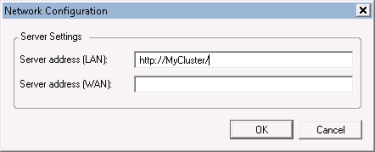

- Repeat these steps for all services listed in the Add/Remove Registered Services window. Click Network.
- In the Network Configuration window, change the URL address of the server to the URL address of the cluster. (This step only applies to the first server in the cluster.) Click OK.
