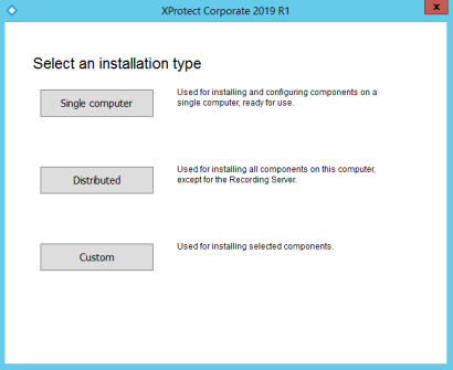

This means that when you install the XProtect VMS, do not use the Single computer option in the installer, because this automatically installs the Mobile Server.
Instead, install the XProtect VMS system with either the Distributed or Custom options. These do not install the Mobile Server.
After the XProtect VMS has been installed, the download page on the Management Server will list the additional XProtect DLNA Server and Mobile Server components. Do not install these servers.
