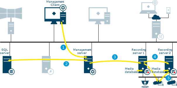

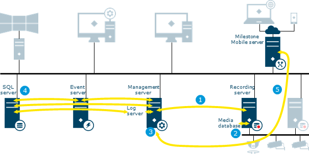

System communication and data flow
Server communication
Component
Port
Protocol
Bandwidth
1
Management server - Recording server
9000
TCP
1 kbit/call
2
Recording server - Media database
3
Management server - Internal
8080
UDP
1 kbit/call
4
SQL database communication
1433
TCP
1 kbit/call
5
Management server - Mobile server
80
HTTP
1 kbit/call

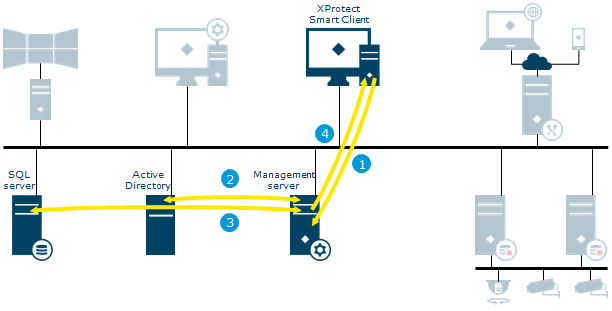

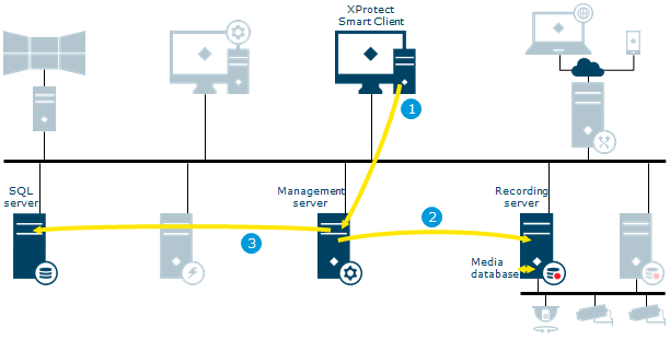

Login from XProtect Smart Client
Process
Port
Protocol
Bandwidth
1
XProtect Smart Client connects to the management server and attempts to log in
Configurable.
Typically port 80 for an AD user and port 443 for a basic user
HTTP for an AD user and HTTPS for a basic user
Low
1 kbit/call
2
The management server contacts Active Directory to authenticate the user
OS- and AD-dependent
Low
5 kbit/call
3
User-specific configuration is retrieved from the SQL database
1433
TCP
Depends on configuration
4
Login is granted and the configuration is sent to XProtect Smart Client
Configurable.
Depends on configuration, Typically 1-10 MByte

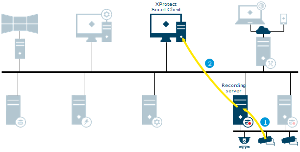

Live video and audio
Process
Port
Protocol
Bandwidth
1
Live streams from cameras retrieved by the recording server
Configurable.
Typically port 80
Configurable.
Typically RTSP, UDP, TCP/IP
Device configurable.
Typically 1-10 Mbit/s
2
Streams are sent to XProtect Smart Client on request
Configurable.
The default port is 7563
Configurable, TCP/IP, UDP Multicast.
The default is TCP/IP
Usage dependable, sum of camera streams viewed

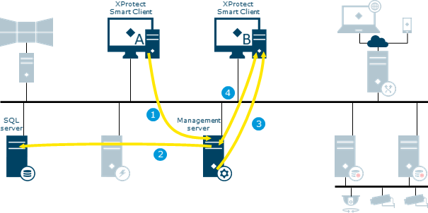

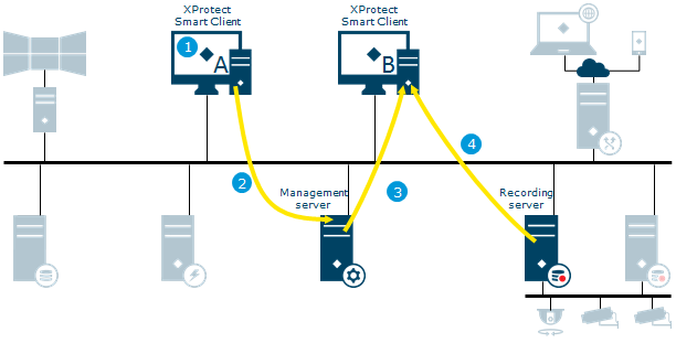

Management server – view update
Process
Port
Protocol
Bandwidth
1
View updated on XProtect Smart Client
Configurable.
Low
1 kbit/call
2
The system configuration is stored in the SQL database
1433
TCP
Low
1 kbit/call
3
The management server sends notification about view update to XProtect Smart Clients
Configurable.
Low
1 kbit/call + constant low use
4
XProtect Smart Clients retrieves and applies the new view
Configurable.
Typically port 80 for an AD user and 443 for a basic user
Low
1 kbit/call

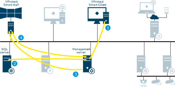

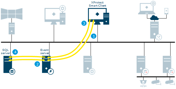

XProtect Smart Wall
Process
Port
Protocol
Bandwidth
1
An XProtect Smart Client user updates the XProtect Smart Wall view
Configurable. The default is 5432 (disabled by default)
TCP/IP
Low
1 kbit/call
2
The XProtect Smart Wall view configuration is updated and stored in the SQL database
1433
TCP
Low
1 kbit/call
3
The management server sends a notification to the XProtect Smart Client running the XProtect Smart Wall
Configurable.
Typically 80 for an AD user and 443 for a basic user
Low
1 kbit/call
4
The XProtect Smart Client running the XProtect Smart Wall retrieves and applies new layout
Configurable.
Low
1 kbit/call

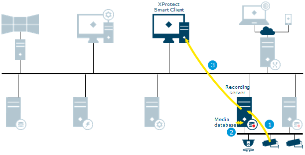

Play back video and audio
Process
Port
Protocol
Bandwidth
1
Recording stream from cameras retrieved by the recording server
Configurable.
Typically port 80
Configurable.
2
The stream is recorded in the recording server database based on rules
N/A
N/A
3
The recorded stream is retrieved by XProtect Smart Client on playback request
Configurable.
TCP/IP

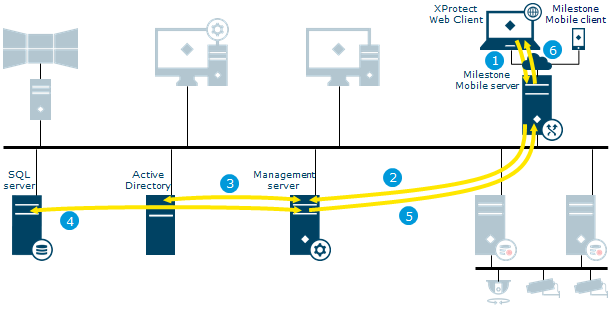

Login from XProtect Web Client and XProtect Mobile
Process
Port
Protocol
Bandwidth
1
Login request from XProtect Web Client or XProtect Mobile received on the mobile server
Configurable.
Typically 8081 for HTTP and 8082 for HTTPS
HTTP or HTTPS
Low
1kbit/call
2
The mobile server forwards request to the management server
Configurable.
Low
1kbit/call
3
Low
1kbit/call
4
1433
TCP
Configuration dependent
5
Information returned to the mobile server
Configurable.
HTTP for an AD User and HTTPS for a basic user
Configuration dependent, typically 1-10 MByte
6
The login is granted and configuration is sent to XProtect Web Client or XProtect Mobile
Configurable.
HTTP or HTTPS
Configuration dependent, typically < 100 kByte

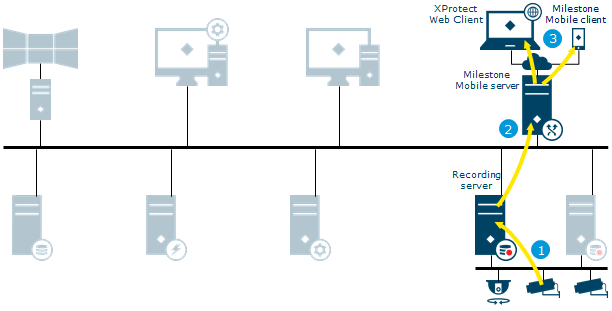

Live video for XProtect Web Client and XProtect Mobile
Process
Port
Protocol
Bandwidth
1
Live stream(s) from cameras retrieved on the recording server
Configurable.
Typically port 80
Configurable.
2
Streams are sent to the mobile server for transcoding or as direct streaming
Configurable.
The default is 7563
3
Video is streamed to the clients
Configurable.
HTTP or HTTPS
Transcoding: typically 50–200 kbit/s
Native: device configurable.
Typically 0.05-1 Mbit/s

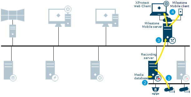

Recording and playback video for XProtect Web Client and XProtect Mobile
Process
Port
Protocol
Bandwidth
1
Recording stream from cameras retrieved on the recording server
Configurable.
Typically port 80
Configurable.
2
Configurable.
The default is 7563
Configurable. TCP/IP, UDP Multicast.
The default is TCP/IP.
3
Recordings are sent to the mobile server for transcoding or as direct streaming
Configurable.
HTTP or HTTPS
4
Video is streamed to clients

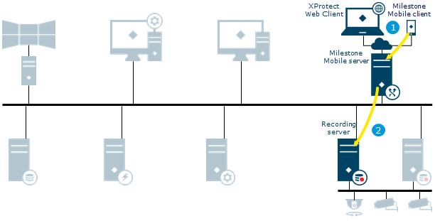

Video push
Process
Port
Protocol
Bandwidth
1
Video push stream from a device running XProtect Mobile is sent instantly to the mobile server
Configurable.
Typically port 8081 for HTTP and port 8082 for HTTPS
HTTP or HTTPS
Usage dependable, resolution and frame-rate set up in the mobile device.
Typically 0.05 – 1 Mbit/s
2
The video push stream is retrieved by recording server using the specific video push device driver
Configurable.
Typically port 40001 (40002, 40003, if many devices are present)
TCP/IP

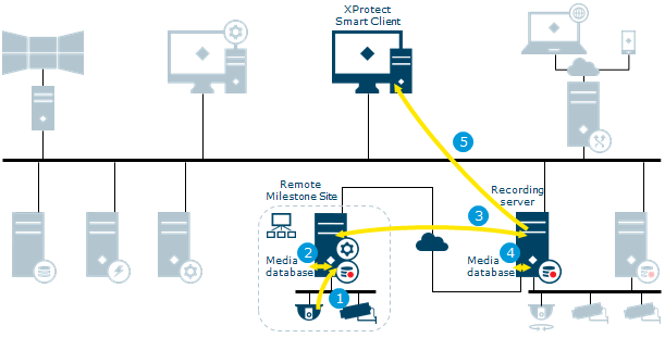

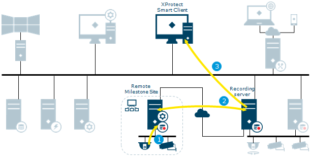

Milestone Interconnect live
Process
Port
Protocol
Bandwidth
This illustrates how XProtect Smart Client users, specified for the interconnected system, only need to log into the management server on the central site to view video
1
Live stream(s) from the remote site cameras retrieved by the remote site recording server
Configurable.
Typically 80
Configurable.
2
Live streams from the remote site recording server retrieved by the central site recording server
Configurable.
The default is 7563*
TCP/IP
* In XProtect Professional VMS the default port is 80, events 22331, central 1237 must be open.
The recording server on the central site connects to the remote site in the same way as a XProtect Smart Client
3
Stream(s) are sent to XProtect Smart Client on request
Configurable.
The default is 7563

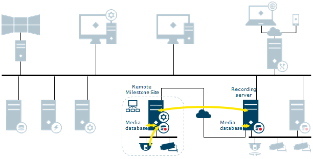

Milestone Interconnect recording options
Process
Port
Protocol
Bandwidth
This highlights some of the different options when configuring your system recording settings
No recording
Record at remote site only
Retrieve recordings from remote site on request
Retrieve recordings from remote site based on rule (time profile)
Record at central site only
Retrieve recordings from remote site after site link down
Record at both sites
Combinations of above and other options
These options could also be combined with cameras that have edge storage capabilities

This illustrates when recording is done on both sites. Recordings can be retrieved to the central site based on schedule, event or request. XProtect Smart Client users, specified for the interconnected system, only need to log into the management server on the central site to view video
1
Recording stream from the remote site cameras retrieved by the remote site recording server
Configurable.
Typically 80
Configurable.
2
The stream is recorded in the remote site recording server database based on rules
N/A
N/A
3
Recording stream from the remote site recording server retrieved by the central site recording server
Configurable.
TCP/IP
Sum of camera streams viewed
* In XProtect Professional VMS the default port is 80, events 22331, central 1237 must be open. The recording server on the central site connects to the remote site in the same way as a XProtect Smart Client
4
The stream is recorded in the central site recording server database based on rules. Recordings not available due to remote site link downtime can be retrieved automatically or based on schedule, event or request
N/A
Configurable by remote retrieval settings
5
The recorded stream(s) are retrieved by XProtect Smart Client on playback request
Configurable.
The default is 7563
TCP/IP

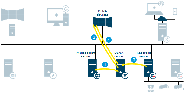

XProtect DLNA Server
Process
Port
Protocol
Bandwidth
1
The XProtect DLNA Server connects to the management server to authorize itself with the provided credentials
Configurable.
Low
1 kbit/call
2
A DLNA device scans the network and connects to the XProtect system via the XProtect DLNA Server and requests a live camera video stream
Configurable.
The default port is 9100
HTTP
Low
1 kbit/call
3
XProtect DLNA Server retrieves the requested camera video stream from the recording server
Configurable.
TCP/IP
4
XProtect DLNA Server sends the live video stream from the requested camera to the DLNA device
Configurable.
The default port is 9200
HTTP
Only H.264 encoded camera streams are supported. If a camera supports multiple streams, only the default stream is sent. The system administrator manages the entire XProtect DLNA Server configuration from the Management Client. For example, selecting cameras available

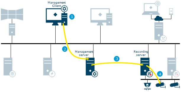

Management Client configuration update
Process
Port
Protocol
Bandwidth
1
Configuration updated on the Management Client
2
Changes are stored on the management server
Configurable.
Low
10 kbit/call
3
Configuration update sent to relevant components. In this case, the recording server
9000
TCP/IP
Low
1 kbit/call
4
If updates concern cameras, the recording server applies new settings
Configurable.
Typically 80 for HTTP and 443 for HTTPS
HTTP or HTTPS
Low
1 kbit/call

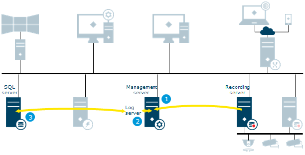

Log server
Process
Port
Protocol
Bandwidth
1
The Management server or recording server creates a log message
9000
TCP
Low
1 kbit/call
2
The log message is forwarded to the log server
22337
HTTP
Low
1 kbit/call
3
The log message is stored in the log server's SQL database
1433
TCP
Low
1 kbit/call

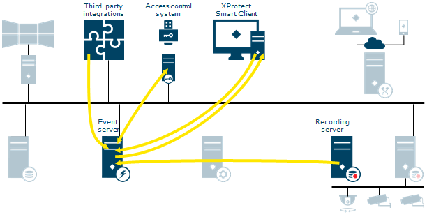

Event server
Process
Port
Protocol
Bandwidth
Data about alarms, access control or map updates are received by the event server
Third-party integrations MIP message communication
22333
TCP/IP
Low
1 kbit/call
Access control integrations
Depends on the integration
TCP/IP
Low
1 kbit/call
XProtect Access. The event server Plug-in is a client to the access control system
Random or fixed.
Paxton 8025
TCP/IP
Low
1 kbit/call
Analytics events
Configurable.
The default port is 9090
TCP/IP
Low
1 kbit/call
Generic events
Configurable.
The default ports are 1234 and 1235
TCP/IP, UDP
Low
1 kbit/call
Recording server
7563
TCP
Low
1 kbit/call
The event server sends data to XProtect Smart Client to show in alarm list, XProtect Access or the map overview.
The XProtect Smart Client user responds to the notification and returns data to event server

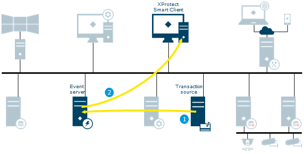

XProtect Transact
Process
Port
Protocol
Bandwidth
1
Transaction data generated by the transaction source is sent to the event server and stored
Configurable.
Typically 80
TCP/IP
Low
10 kbit/call
2
The event server sends transaction data to XProtect Smart Client. View items containing transaction data and the associated video is updated
Configurable.
The default is 22331
22333
TCP/IP
Low
1 kbit/call
The system administrator manages the entire XProtect Transact configuration from the Management Client. For example, setting up transaction sources, associated cameras, definitions and events

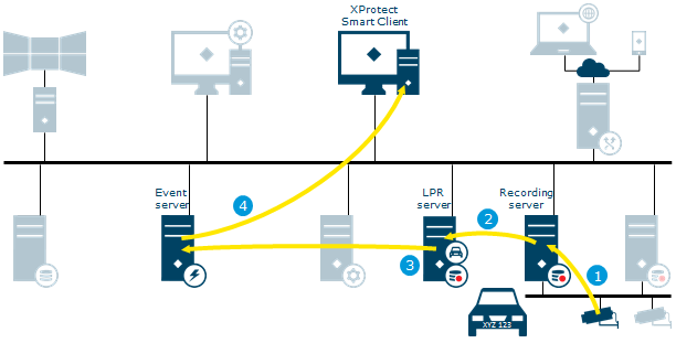

XProtect LPR
Process
Port
Protocol
Bandwidth
1
Live streams from cameras configured for LPR (License Plate Recognition) retrieved by the recording server
Configurable.
Typically 80
Configurable.
2
Streams from the recording server retrieved by the LPR server
Configurable.
The default is 7563
TCP/IP
3
The LPR server recognizes license plates by comparing them with the license plate characteristics of the installed country modules. Found license plates are compared with the license plate match list requests from the event server LPR plug-in
22334
TCP/IP
Low
1 kbit/call
4
The event server sends events and alarms to XProtect Smart Client when there is a match
Configurable.
22333
TCP/IP
Low
1 kbit/call
The system administrator manages the entire XProtect LPR configuration, for example, setting up events, alarms, and match lists from the Management Client. To be able to configure XProtect LPR from the Management Client you must install the LPR plug-in on the Management Client computer
View and manage alarms
Process
Port
Protocol
Bandwidth
1
XProtect Smart Client requests an alarm list from event server
Configurable.
The default port is 22331
TCP/IP
Low
1 kbit/call
2
The alarm list is retrieved from the SQL database and returned to XProtect Smart Client
1433
TCP
Low
100 kbit/call
3
The alarm is handled and its state/details is updated by the user
4
New state/details stored in the SQL database
1433
TCP
Low
1 kbit/call

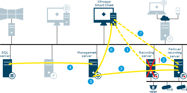

Recording server failover
Process
Port
Protocol
Bandwidth
1
Video streamed from the recording server
Configurable.
Default TCP/IP
2
Alive messages exchanged between recording and failover recording server
Configurable.
Default is 11000
Low
1 kbit/call
3
Cold standby: failover message sent, configuration retrieved, start failover
Hot standby: failover message sent, start failover
80
HTTP
4
Configuration updated with active failover recording server
1433
TCP
Low
1 kbit/call
5
Update configuration message sent to the management server
80
HTTP
Low
1 kbit/call
6
Update message distributed to all clients
Configurable.
Low
1 kbit/call
7
Video streamed from failover recording server
Configurable.
Default TCP/IP
Media retrieved from failover recording server when recording server is available
5210
TCP

Move hardware
Process
Port
Protocol
Bandwidth
1
The user moves hardware from recording server 1 to recording server 2 in Management Client
2
The management server receives the update in the system configuration and stores it in the SQL database
1433
TCP
Low
1kbit/call
3
The management server sends update to recording server 1
9000
TCP
Low
1kbit/call
4
The management server sends update to recording server 2
9000
TCP
Low
1kbit/call
5
Recording server 2 connects to Hardware. All new recordings are stored in the recording server 2 database
Old recordings are still available on recording server 1. The system deletes them when the retention time expires. Recordings marked with evidence lock are not deleted until the evidence lock's retention time expires
5210
TCP
Clients connect to recording server 2
