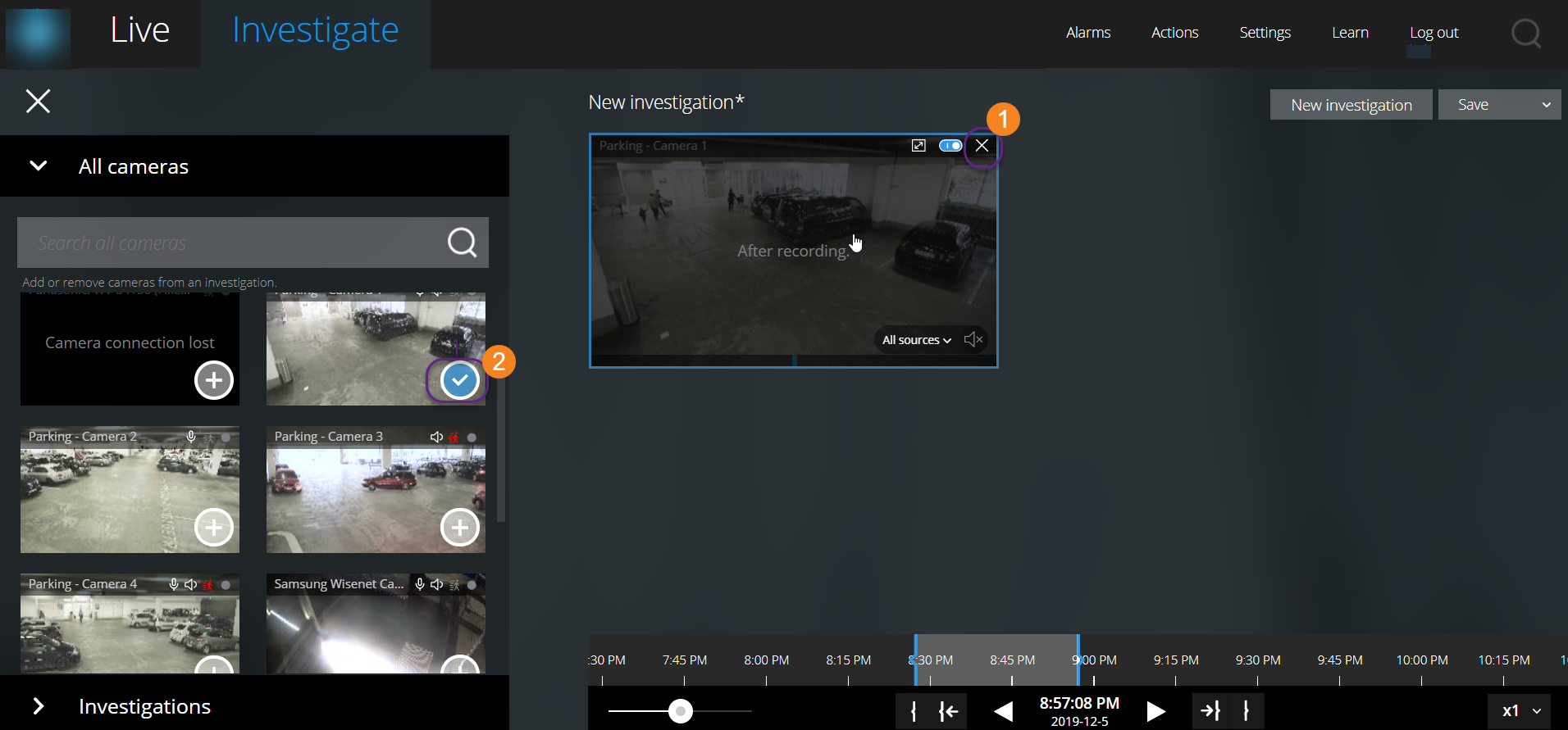

On the Investigate tab, you can remove the unnecessary cameras from a camera group if you:
- Hover over the camera
and then, in the upper right-hand corner, click
- On the side panel, click
- On the side panel, double-click the camera that you want to remove
