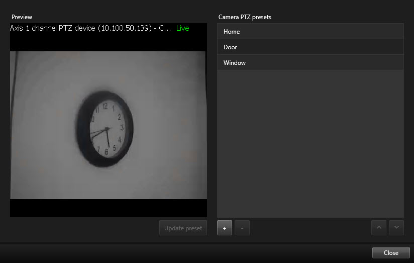

- Click Manage PTZ presets to open the window.
- Click
to add a new preset entry.

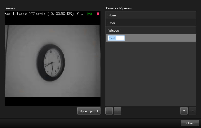

- Select the PTZ preset entry and enter a new name for the PTZ preset.
- Use the PTZ buttons to navigate to the relevant position and click Update preset to save.
- Use the arrows to move a PTZ preset up or down in the list. This can be useful if your list contains many presets.

- Click Manage PTZ presets and in the dialog box, select the PTZ preset.
- To edit the name of the preset, ensure the name of the PTZ preset is highlighted. Click the text and overwrite the existing name.
- If the camera is not in the correct position, use the PTZ buttons to navigate to the required position and then click Update preset to save.
- Use the up or down arrows to arrange the PTZ presets on the list.
