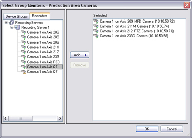

Specify which devices to include in a device group
- In the Overview pane, right-click the relevant device group folder.
- Select Edit Device Group Members.
- In the Select Group Members window, select one of the tabs to locate the device.
A device can be a member of more than one device group.
- Select the devices you want to include, and click Add or double-click the device:
- Click OK.
