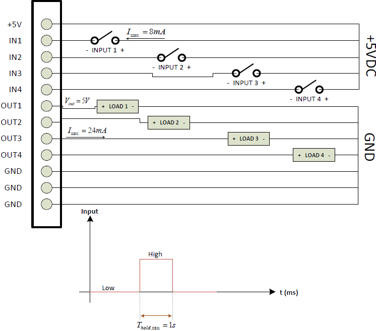

Husky IO Module
The Husky IO Module is a part of your Milestone Husky product. It is a built-in IO module with four inputs and four outputs, and it is listed in the Management Client navigation pane under Devices as a camera. You can configure the IO module for use with Rules and Events.
For detailed feature descriptions and procedures for configuration and maintenance, see the administrator manual for XProtect VMS.
Husky IO Module setup
The module is installed and added as a hardware device with the following details:
| Hardware Device Name | Husky IO Module |
| Address | 127.0.0.1 |
| Port | 1337 |
| Device Driver | Husky IO Module |
If you have deleted the Husky IO Module in the Management Client and want to add it again, use the Reconfigure option in Husky Assistant. For more information, see Reconfigure.
Connection diagram
