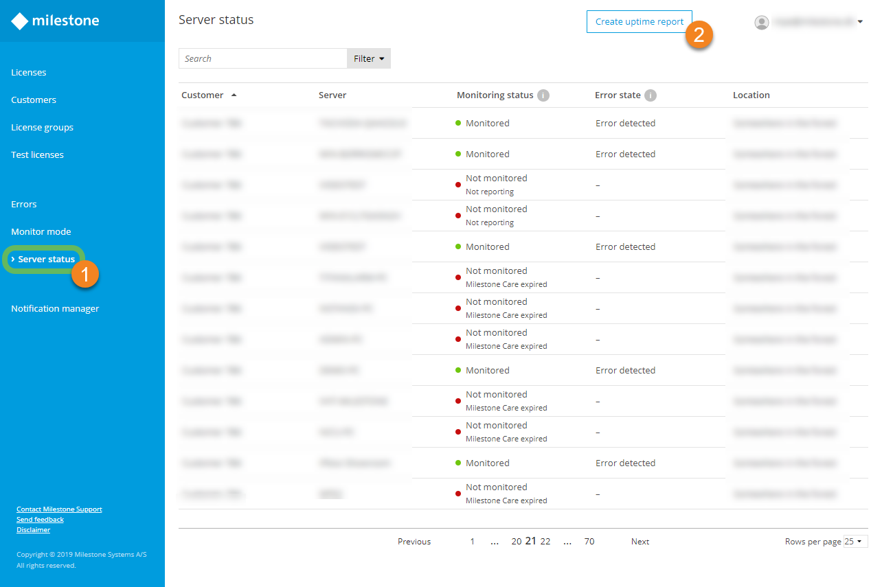

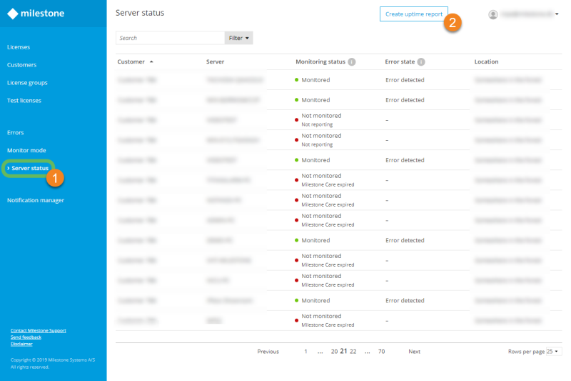

In the main menu, select Server status
, and then select Create uptime report

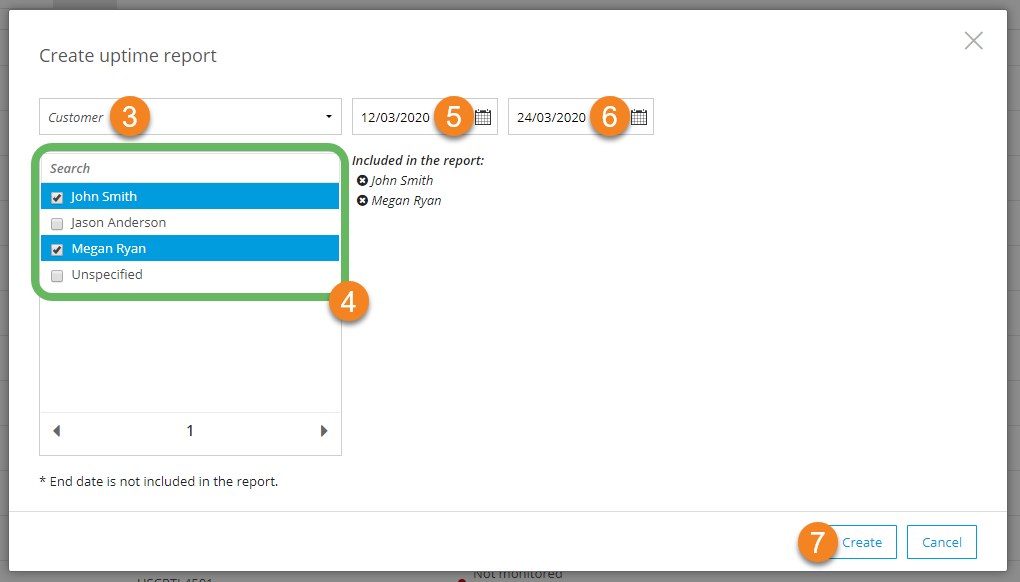

In the Create uptime report dialog box, select a filter for the report
- Customer - The report contains information about all servers that are associated with the selected customers, independent of licenses
- License - The report contains information about all servers, categorized by licenses
- Location - The report contains information about all servers at specific locations independent of customers and licenses
- Server - The report contains information about specific servers independent of customers, licenses, or locations
- Use the search field to refine the list of items to select from, and select the items that you want to include in the report
Specify a start date
and end date
for the report.
- Select Create
