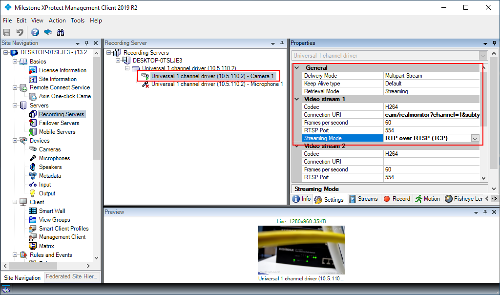

Configuring the Universal Driver
In order for the Universal driver to receive video/audio it needs to know the Retrieval Mode, URI, codec and port.

Video Channel settings
Setting Name |
Possible values |
Description |
Delivery Mode |
Multipart Stream Non Multipart Stream |
Used only when HTTP streaming is selected. Controls whether to use HTTP multipart data transfer (see https://www.w3.org/Protocols/rfc1341/7_2_Multipart.html) |
Keep Alive type |
Default OPTIONS OPTIONS (no URL) GET_PARAMETER RTCP Never |
Used only when RTSP streaming is selected. Defines what type of RTSP connection keep alive should be used. Default – selected by the driver as the most appropriate. OPTIONS – RTSP OPTIONS command will be send by the driver periodically. OPTIONS (no URL) – RTSP OPTIONS command without URL will be send by the driver periodically. GET_PARAMETER – RTSP GET_PARAMETER command will be send by the driver periodically. RTCP – Driver will send RTCP client messages. Never – do not use keep alive. The selection for this setting depends on the requirements of the device. If you experience periodic interruptions and reconnections of the stream (once every 30 seconds to once every 5 minutes) try changing this setting. |
Retrieval Mode |
Streaming Snapshot |
Streaming – RTSP streaming or HTTP streaming will be used. Snapshot – JPEG snapshot will be used to retrieve frames. |
Codec |
MJPEG MPEG-4 H264 H265 |
The codec of the incoming video that the driver should expect. This should match the codec selected on the device for the video stream. Can be checked on device’s Web Page or using VLC (see Testing with VideoLan Player (VLC)) |
Connection URI |
URI to be used for establishing a video stream or to request JPEG snapshots. NOTE: the URI must be without the IP/hostname, port and the first slash (“/”) of the URL. Example: If the URL of the video stream for the device is: “rtsp://192.168.0.10:5544/channel1/stream1” then the URI should be set as: “channel1/stream1” (without the quotes) The IP/hostname and port will be taken from the settings. |
Frames per second |
0.00028 - 60 |
Used only when the JPEG Snapshot mode is selected. Controls the interval at which to poll the device for JPEGs. Examples: 60 – poll the device 60 times per second 1 – poll the device once every second 0.1 – poll the device once every 10 seconds 0.00028 – poll the device once every hour |
RTSP Port |
1 - 65535 |
Used only if RTSP streaming mode is selected. Sets the RTSP port to be used when connecting to the device. |
Streaming Mode |
RTP/UDP RTP/RTSP/TCP HTTP RTP/UDP multicast RTP/RTSP/HTTP/TCP |
Used only when “Streaming” is selected for Retrieval Mode. RTP/UDP – RTSP will be used and during RTSP SETUP UDP unicast RTP transfer will be requested from the device. RTP/RTSP/TCP - RTSP will be used and during RTSP SETUP TCP unicast interleaved RTP transfer will be requested from the device. HTTP – HTTP streaming mode will be used. The driver will issue a HTTP GET command and will expect in response to get the video data. If HTTPS is enabled, the HTTPS port will be used. RTP/UDP multicast - RTSP will be used and during RTSP SETUP UDP multicast RTP transfer will be requested from the device. RTP/RTSP/HTTP/TCP – RTSP will be used and tunneled through the HTTP port. If HTTPS is enabled, the HTTPS Port will be used. |

Configurations for different stream types:
RTSP/RTP over UDP |
Retrieval Mode |
Streaming |
Codec |
MJPEG, MPEG4, H264 or H265 |
Streaming Mode |
RTP/HTTP |
RTSP/RTP over TCP |
Retrieval Mode |
Streaming |
Codec |
Streaming Mode |
RTP/RTSP /TCP |
RTSP/RTP over multicast |
Retrieval Mode |
Streaming |
Codec |
Streaming Mode |
RTP/UDP multicast |
HTTP streaming |
Retrieval Mode |
Streaming |
Delivery Mode |
“Multipart Stream” or “Non Multipart Stream” |
Codec |
Streaming Mode |
HTTP |
JPEG Snapshots |
Retrieval Mode |
Snapshot |
Codec |
MJPEG |
Frames per second |
Needed snapshot interval |
Streaming Mode |
HTTP |
RTSP over HTTP |
Retrieval Mode |
Streaming |
Codec |
Streaming Mode |
RTP/RTSP/HTTP /TCP |
RTSP over HTTPS |
Retrieval Mode |
Streaming |
Codec |
Streaming Mode |
HTTPS Enabled |
Yes |
HTTPS Validate Certificate |
Yes* |
HTTPS Validate Hostname |
Yes* |
*Note: For testing purposes only “HTTPS Validate Certificate” and “HTTPS Validate Hostname” can be disabled.
