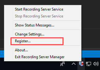

When you register a recording server, you configure it to connect to your management server. The part of the management server that handles registration is the Authorization Server service.
  1. On the recording server, right-click the Recording Server Manager tray icon in the notification area and stop the Recording Server service.
  2. When the recording server is not running, right-click the Recording Server Manager tray icon and select Register.

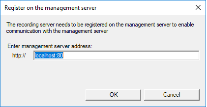

  3. Enter the address of the management server that you want the recording server to connect to and click OK.

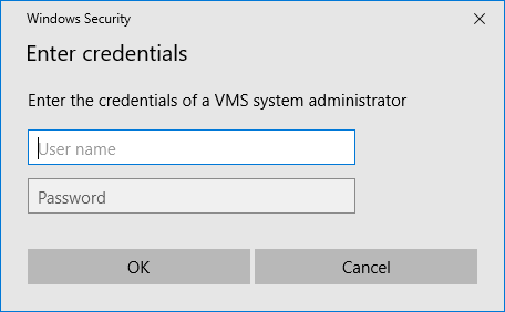

  4. Enter the user name and password of a system administrator of XProtect and click OK.
  5. A confirmation window pops up and the recording server is registered. Right-click the Recording Server Manager tray icon in the notification area and start the Recording Server service.

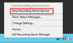

You do not need to re-install recording servers to specify the parameters of the management servers, but you can change/verify its basic configuration:
  1. On the computer that runs the recording server, right-click the Recording Server icon in the notification area.
  2. Select Stop Recording Server service.
  3. Right-click the Recording Server icon again and select Change Settings.
