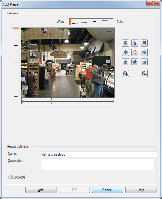

Add a preset position (type 1)
To add a preset position for the camera:
  1. Click Add New. The Add Preset window appears:
  2. The Add Preset window displays a live preview image from the camera. Use the navigation buttons and/or sliders to move the camera to the required position.
  3. Specify a name for the preset position in the Name field.
  4. Optionally, enter a description of the preset position in the Description field.
  5. Select Locked if you want to lock the preset position. Only users with sufficient rights can unlock the position afterwards.
  6. Click Add to specify presets. Keep adding until you have the presets you want.
  7. Click OK. The Add Preset window closes, and adds the position to the Presets tab's list of available preset positions for the camera.

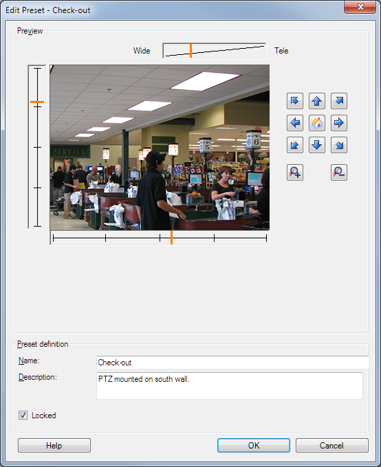

Edit a preset position (type 1 only)
To edit an existing preset position defined in the system:
  1. Select the preset position in the Presets tab's list of available preset positions for the camera.
  2. Click Edit. This opens the Edit Preset window:
  3. The Edit Preset window displays live video from the preset position. Use the navigation buttons and/or sliders to change the preset position as required.
  4. Change the name/number and description of the preset position if needed.
  6. Click OK.
