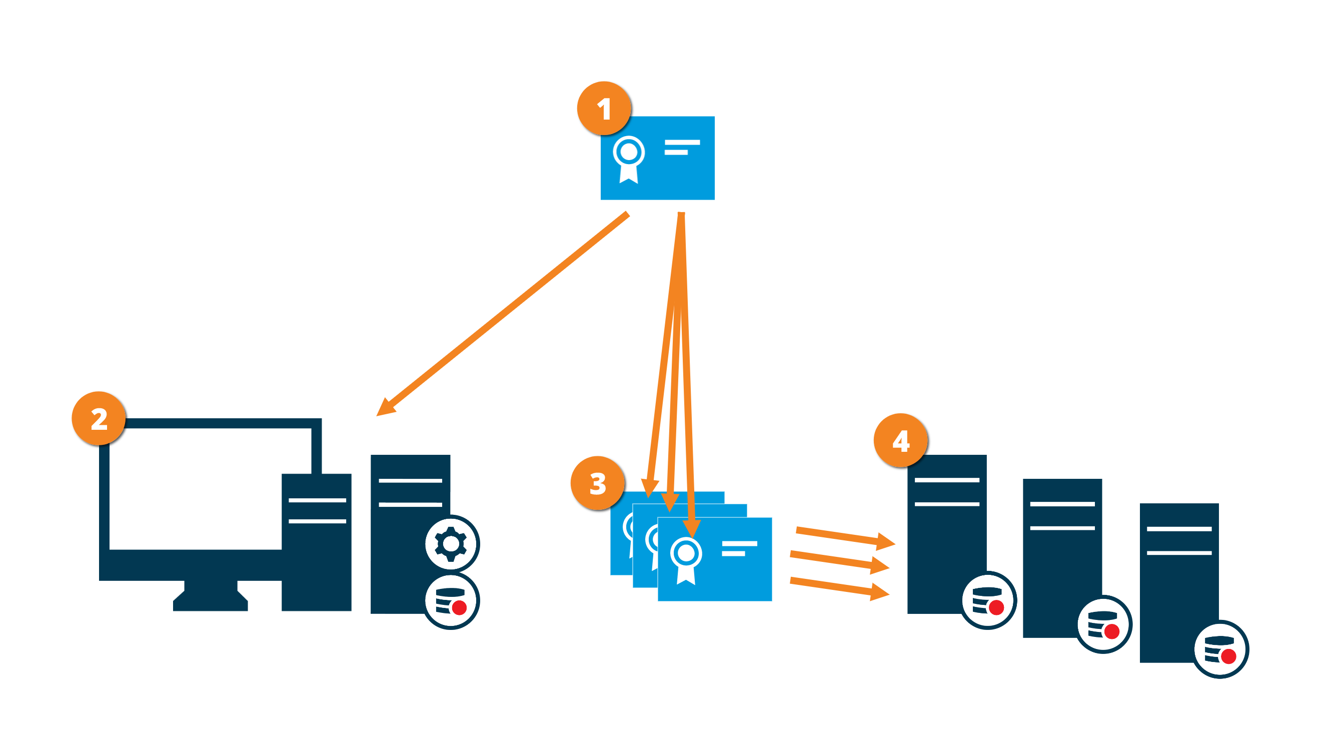

Certificate distribution for management servers
The graphic illustrates the basic concept of how certificates are signed, trusted, and distributed in XProtect VMS to secure the communication to the management server.
A CA certificate acts as a trusted third party, trusted by both the subject/owner (management server) and by the party that verifies the certificate (recording servers)
The CA certificate must be trusted on all recording servers. In this way the recording servers can verify the validity of the certificates issued by the CA
The CA certificate is used to establish secure connection between the management server and the recording servers
The CA certificate must be installed on the computer on which the management server is running
Requirements for the private management server certificate:
  • Issued to the management server so that the management server's host name is included in the certificate, either as subject (owner) or in the list of DNS names that the certificate is issued to
  • Trusted on the management server itself, by trusting the CA certificate that was used to issue the management server certificate
  • Trusted on all recording servers connected to the management server, by trusting the CA certificate that was used to issue the management server certificate

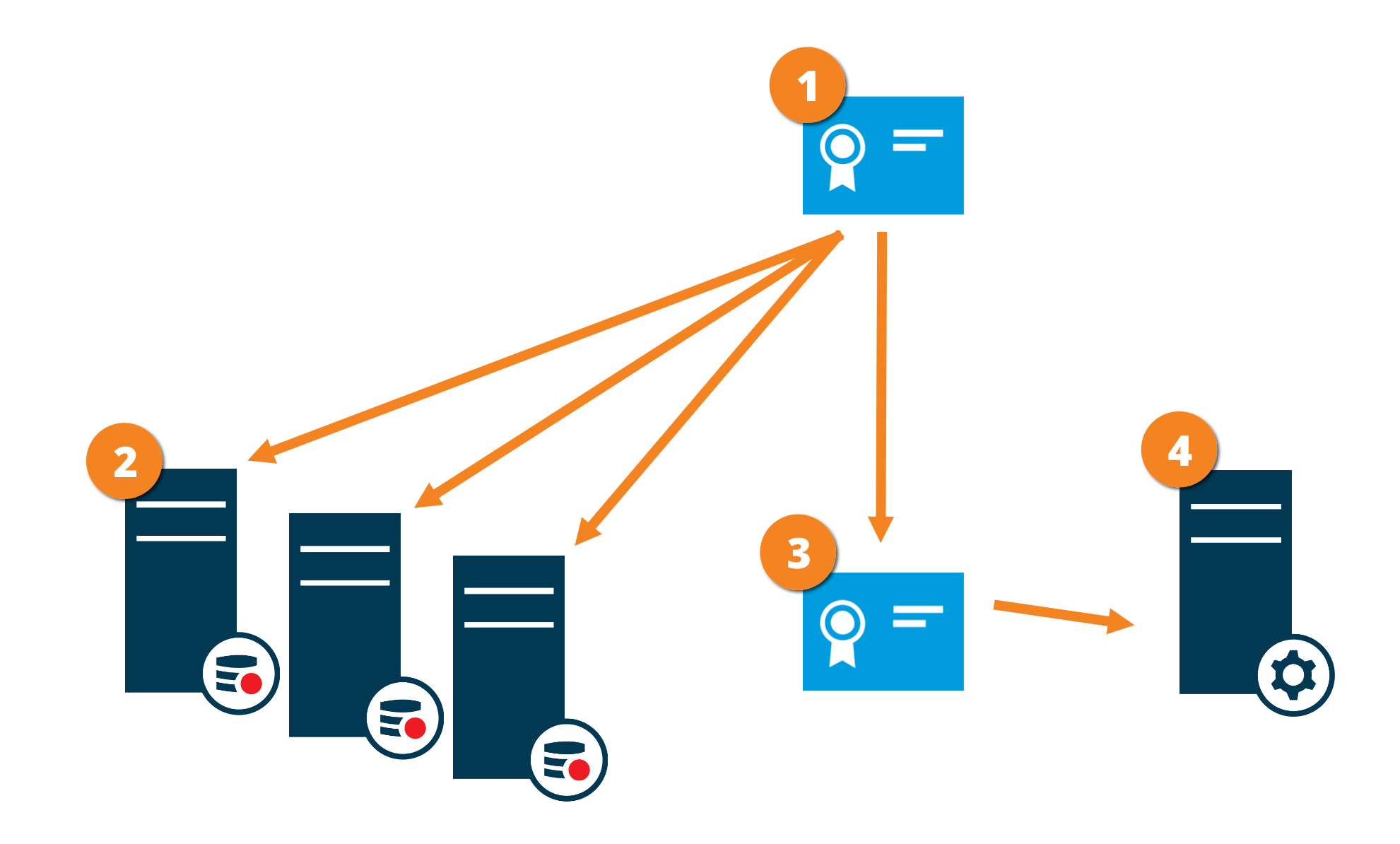

The graphic illustrates the basic concept of how certificates are signed, trusted, and distributed in XProtect VMS to secure the communication from the management server.
A CA certificate acts as a trusted third party, trusted by both the subject/owner (recording server) and by the party that verifies the certificate (management server)
The CA certificate must be trusted on the management server. In this way the management server can verify the validity of the certificates issued by the CA
The CA certificate is used to establish secure connection between the recording servers and the management server
The CA certificate must be installed on the computers on which the recording servers are running
Requirements for the private recording server certificate:
  • Issued to the recording server so that the recording server's host name is included in the certificate, either as subject (owner) or in the list of DNS names that the certificate is issued to
  • Trusted on the management server, by trusting the CA certificate that was used to issue the recording server certificate

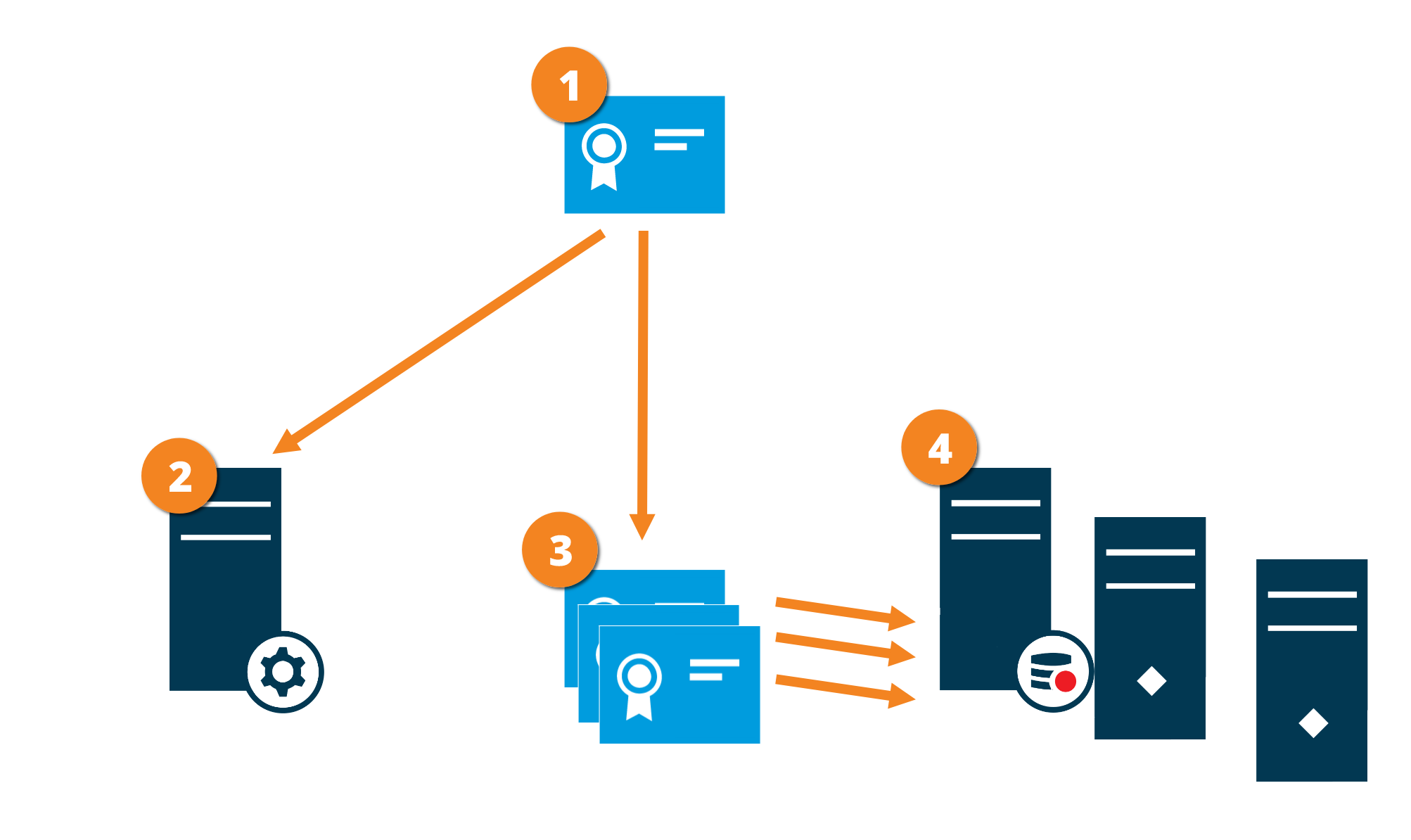

A CA certificate acts as a trusted third party, trusted by both the subject/owner (data collector server) and by the party that verifies the certificate (management server)
The CA certificate is used to establish secure connection between the data collector servers and the management server
The CA certificate must be installed on the computers on which the data collector servers are running
Requirements for the private data collector server certificate:
  • Issued to the data collector server so that the data collector server's host name is included in the certificate, either as subject (owner) or in the list of DNS names that the certificate is issued to
  • Trusted on the management server, by trusting the CA certificate that was used to issue the data collector server certificate

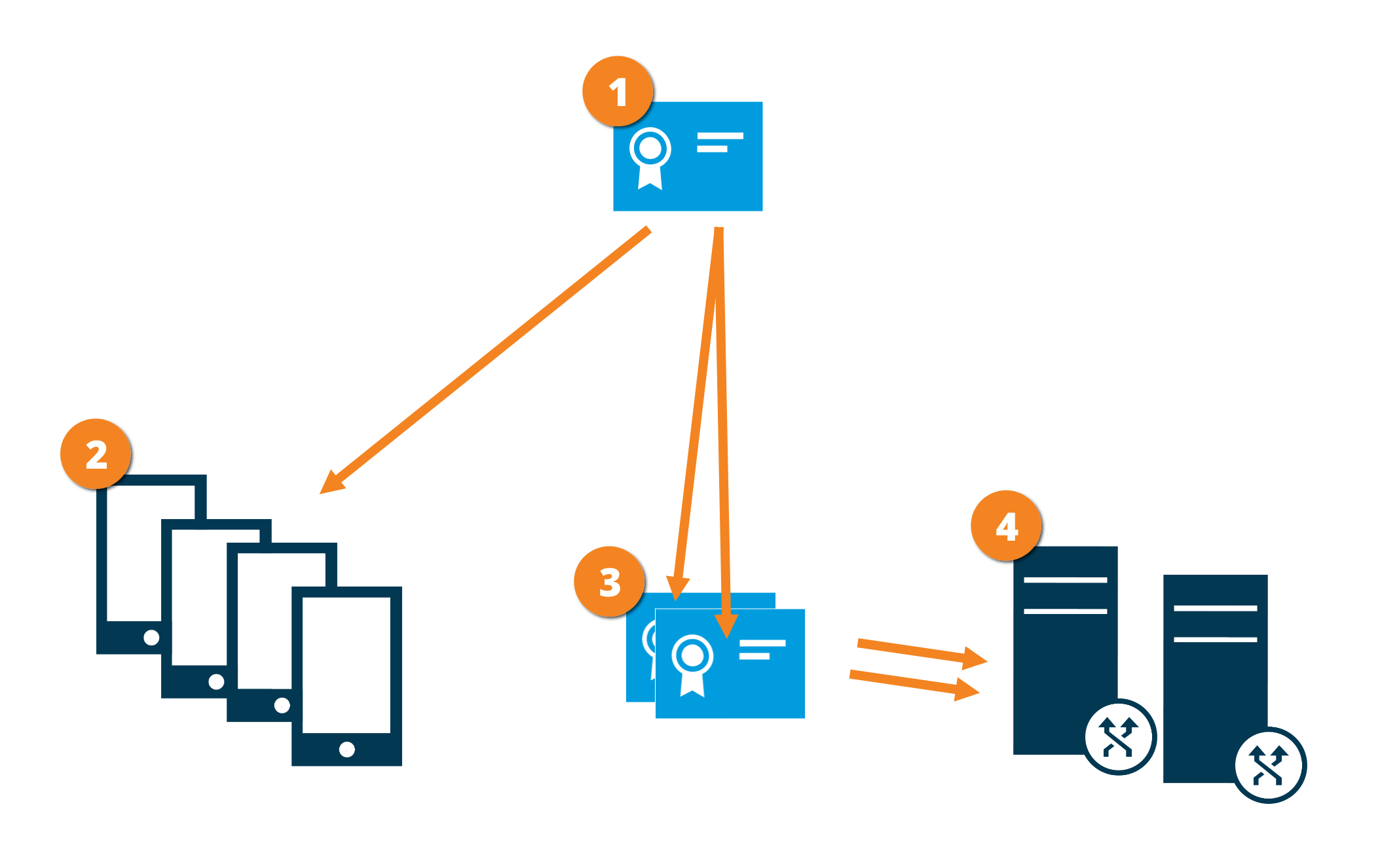

    Certificate distribution for mobile servers
    The graphic illustrates the basic concept of how certificates are signed, trusted, and distributed in XProtect VMS to secure the communication with the mobile server.
    A CA certificate acts as a trusted third party, trusted by both the subject/owner (mobile server) and by the party that verifies the certificate (all clients)
    The CA certificate must be trusted on all clients. In this way clients can verify the validity of the certificates issued by the CA
    The CA certificate is used to establish secure connection between the mobile server and clients and services
    The CA certificate must be installed on the computer on which the mobile server is running
    Requirements for the CA certificate:
    • The mobile server's host name must be included in the certificate, either as subject/owner or in the list of DNS names that the certificate is issued to
    • The certificate must be trusted on all devices that are running services that retrieve data streams from the mobile server
    • The service account that runs the mobile server must have access to the private key of the CA certificate
