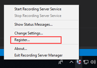

- On the recording server, right-click the Recording Server Manager tray icon in the notification area and stop the Recording Server service.
- When the recording server is not running, right-click the Recording Server Manager tray icon and select Register.

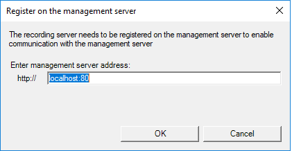

Enter the address of the management server that you want the recording server to connect to and click OK.

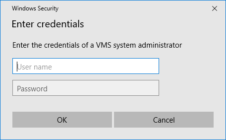

- Enter the user name and password of a system administrator of XProtect and click OK.
- A confirmation window pops up and the recording server is registered. Right-click the Recording Server Manager tray icon in the notification area and start the Recording Server service.

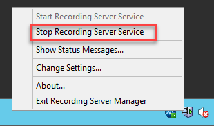

- On the computer that runs the recording server, right-click the Recording Server icon in the notification area.
- Select Stop Recording Server service.
- Right-click the Recording Server icon again and select Change Settings.
