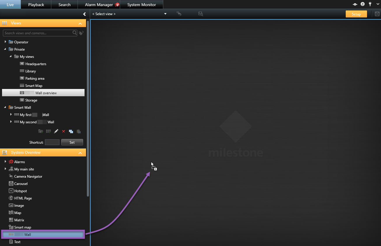

- Add Smart Wall overview to views - to dynamically control what content is displayed on the Smart Wall, first you must add the Smart Wall overview to a view
A collection of video from one or more cameras, presented together in XProtect Smart Client. A view may include other content than video from cameras, such as HTML pages and static images. A view can be private (only visible by the user who created it) or shared with other users.. The Smart Wall overview allows you to drag-and-drop or send cameras and other types of content to the Smart Wall monitors.
- Change the layout of Smart Wall monitors - you can change the preconfigured layout of the Smart Wall monitors by changing the view layout or applying a different preset to a monitor.
Before you can define what content should be displayed on your Smart Wall, first you must add the Smart Wall overview to one or more views. The overview is a graphical presentation of the Smart Wall.

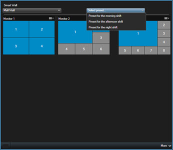

The presets defined by your system administrator are associated with individual monitors. When you change the preset, all monitors in the Smart Wall associated with the preset are updated.
- Open the view that contains the Smart Wall overview.
In the Select preset list, select the preset that you want to display. The affected monitors in the overview change.
- To view the content on the Smart Wall, see XProtect Smart Wall.
Other users can change the preset manually, or rules can change it automatically.
