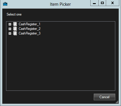

  4. Drag and drop the Transact item into the view item, where you want the transactions and video feed to be displayed. A pop-up window appears.
  5. Select a transaction source, for example a cash register, and click OK. A receipt preview is displayed inside the view item.
