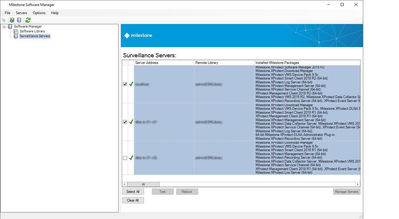

In the navigation pane select Surveillance Servers. This opens the Surveillance Servers window. The first time you use this application, the server list is empty.
You may fill it in two ways – by adding each server individually or by requesting a main surveillance server to compile a list.

Next to each remote server, an icon indicates its connection status. The following icons exist:
Indicates that Milestone Software Manager can connect to the server -
Indicates failure to connect -
Indicates that Milestone Software Manager is currently processing the server
Click the Refresh icon in the toolbar to refresh the icons.

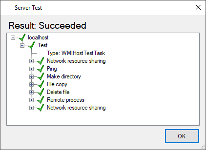

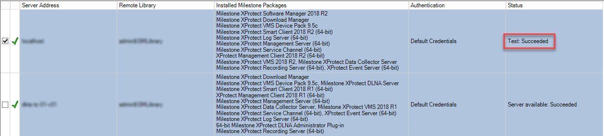

- Select the remote server(s) you wish to test and click Test.
The far right Status column keeps you informed of the progress and status of the test. If relevant, server status icons will also change.
A server test window will present detailed test results.

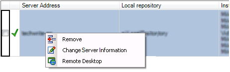

- In the navigation pane select Surveillance Servers.
- Place the cursor over the remote server you wish to work with and right-click.
The following menu options appear: Remove, Change Server Information and Remote Desktop.
- Do one of the following:
- Select Remove to remove the remote server from the server list
- Select Change Server Information to change server information such as the library in which to store software packages and to change default credentials (see Enter default credentials)
- Select Remote Desktop to log on to the remote server via Remote Desktop
