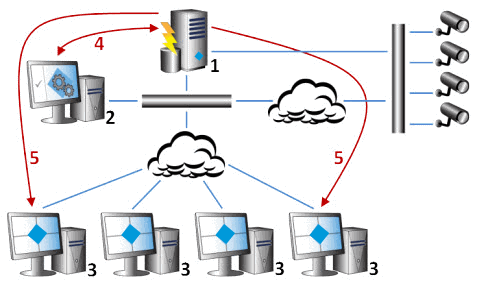

Legend:
  1. Surveillance system
  2. Management Client
  3. XProtect Smart Client
  4. Alarm configuration
  5. Alarm data flow
You handle and delegate alarms in the alarm list in XProtect Smart Client. You can also integrate alarms with the XProtect Smart Client's map functionality.
