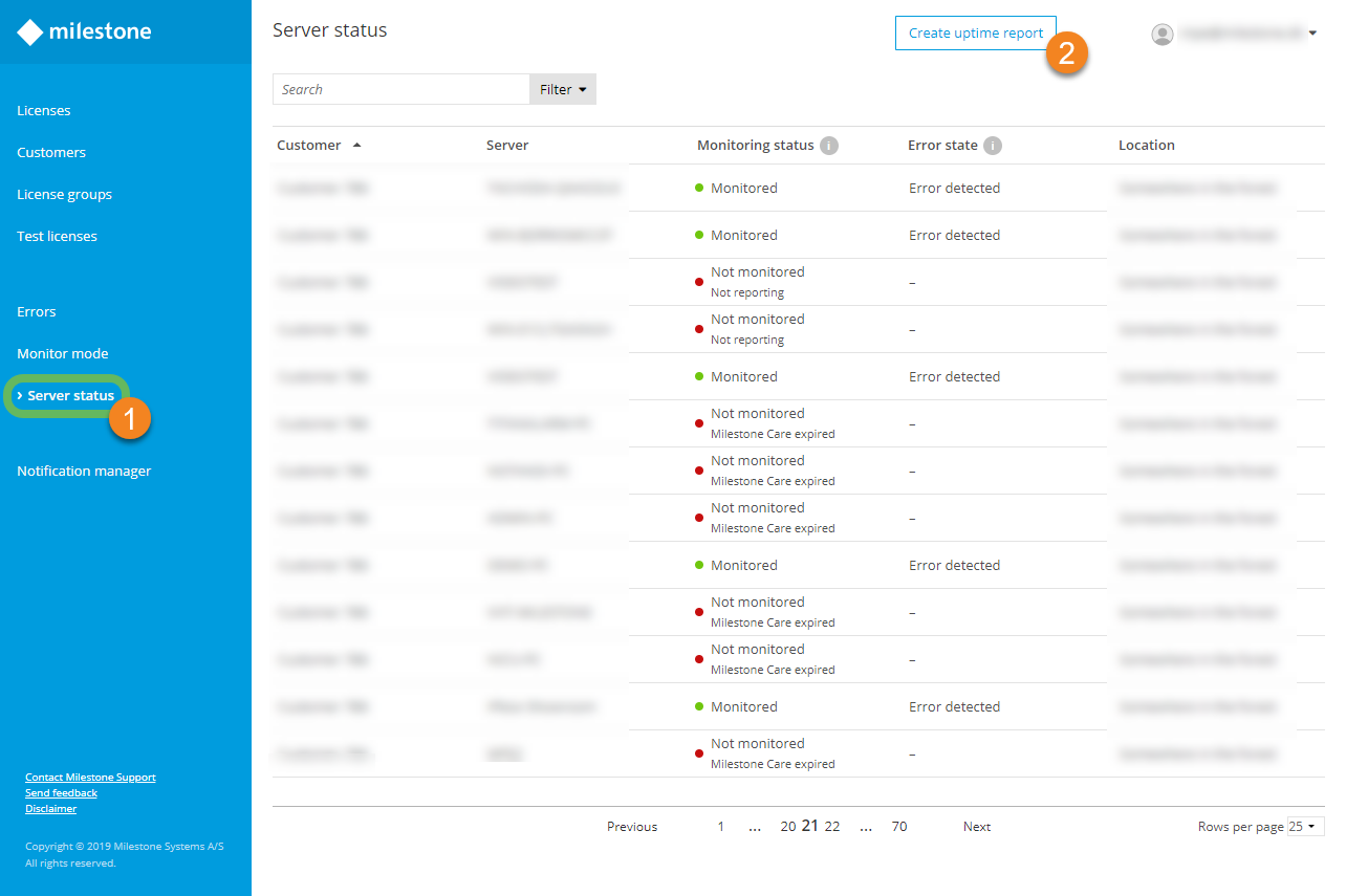

You can use system uptime reports to document the stability of an installation or to troubleshoot a system. To create a system uptime report:
  1. In the main menu, select Server status , and then select Create uptime report .
  2. In the Create uptime report dialog box, select a filter for the report :
