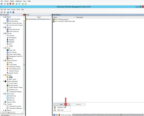

To add Windows users or groups to roles in Management Client, follow these steps:
- Open Management Client.
- Expand the Security node.
- Select the role to which you want to add the Windows users.
- On the Users and Groups tab, click Add, and select Windows user. A pop-up window appears.
- If the domain name does not appear in the From this location field, click Locations.
- Specify the Windows user, and then click OK.
To verify that the Windows user is an AD user, the domain name must appear as a prefix, for example "Domain\John".
