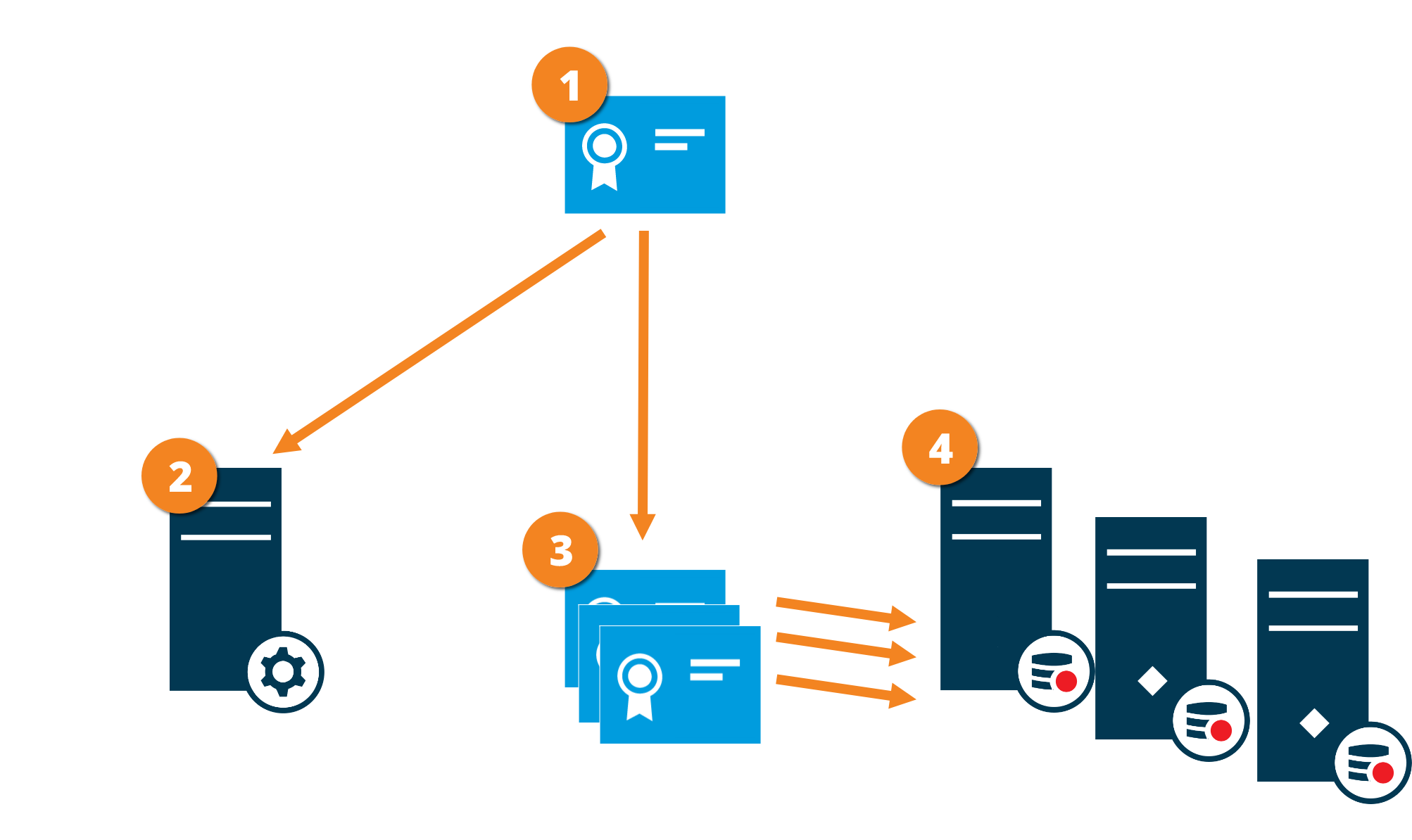

Management server encryption (explained)
You can encrypt the two-way connection between the management server and the recording server. When you enable encryption on the management server, it applies to connections from all the recording servers that connect to the management server. If you enable encryption on the management server, you must also enable encryption on all of the recording servers. Before you enable encryption, you must install security certificates on the management server and all recording servers.
Certificate distribution for management servers
The graphic illustrates the basic concept of how certificates are signed, trusted, and distributed in XProtect VMS to secure the communication to the management server.
A CA certificate acts as a trusted third party, trusted by both the subject/owner (management server) and by the party that verifies the certificate (recording servers)
The CA certificate must be trusted on all recording servers. In this way the recording servers can verify the validity of the certificates issued by the CA
The CA certificate is used to establish secure connection between the management server and the recording servers
The CA certificate must be installed on the computer on which the management server is running
Requirements for the private management server certificate:
  • Issued to the management server so that the management server's host name is included in the certificate, either as subject (owner) or in the list of DNS names that the certificate is issued to
  • Trusted on the management server itself, by trusting the CA certificate that was used to issue the management server certificate
  • Trusted on all recording servers connected to the management server, by trusting the CA certificate that was used to issue the management server certificate

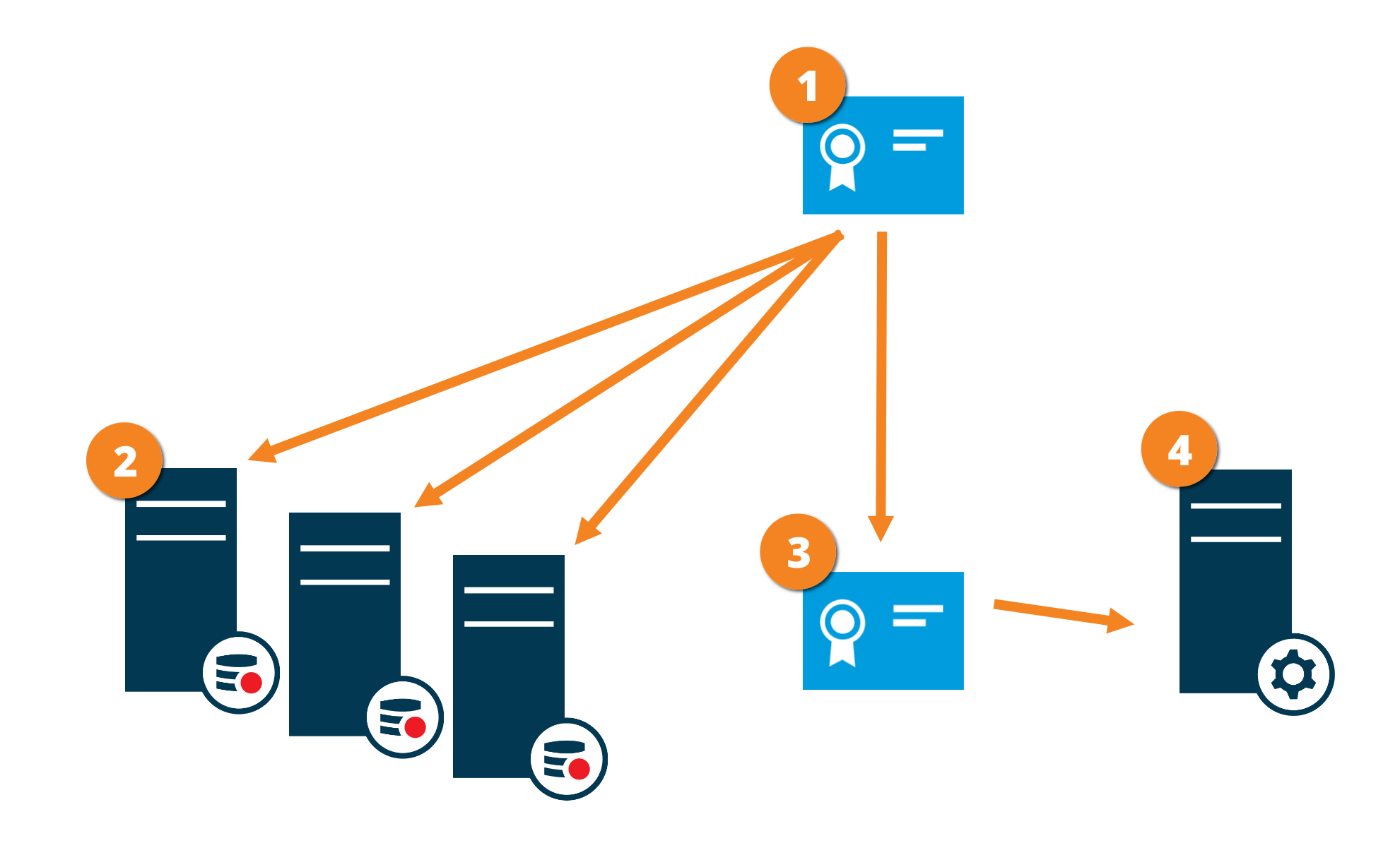

Encryption from the management server to the recording server (explained)
You can encrypt the two-way connection between the management server and the recording server. When you enable encryption on the management server, it applies to connections from all the recording servers that connect to the management server. Encryption of this communication must follow the encryption setting on the management server. So, if management server encryption is enabled, this must also be enabled on the recording servers, and vice-versa. Before you enable encryption, you must install security certificates on the management server and all recording servers, including failover recording servers.
The graphic illustrates the basic concept of how certificates are signed, trusted, and distributed in XProtect VMS to secure the communication from the management server.
A CA certificate acts as a trusted third party, trusted by both the subject/owner (recording server) and by the party that verifies the certificate (management server)
The CA certificate must be trusted on the management server. In this way the management server can verify the validity of the certificates issued by the CA
The CA certificate is used to establish secure connection between the recording servers and the management server
The CA certificate must be installed on the computers on which the recording servers are running
Requirements for the private recording server certificate:
  • Issued to the recording server so that the recording server's host name is included in the certificate, either as subject (owner) or in the list of DNS names that the certificate is issued to
  • Trusted on the management server, by trusting the CA certificate that was used to issue the recording server certificate

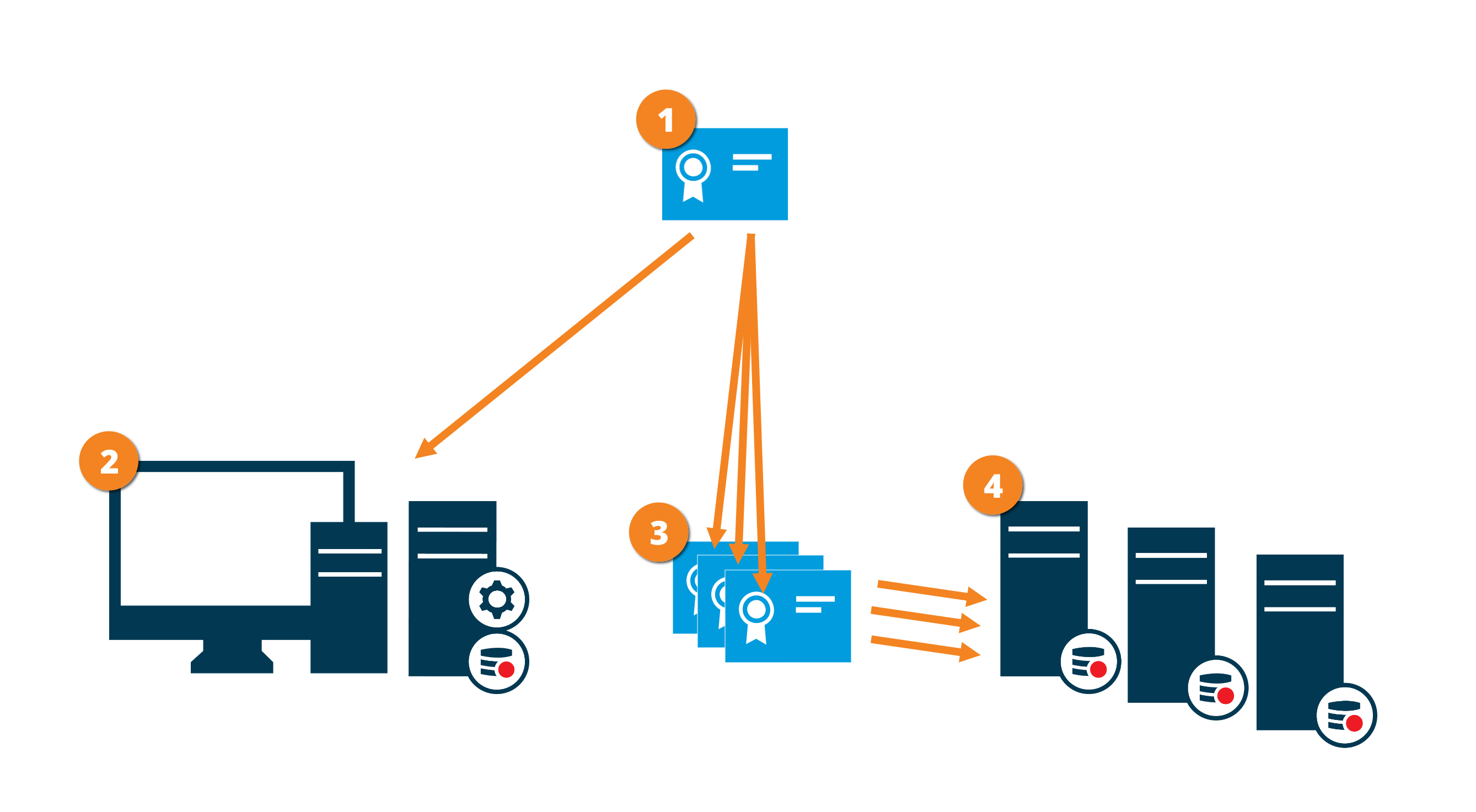

Encryption to clients and servers that retrieve data from the recording server (explained)
When you enable encryption on a recording server, communication to all clients, servers, and integrations that retrieve data streams from the recording server are encrypted. In this document referred to as 'clients':
  • XProtect Smart Client
  • Management Client
  • Management Server (for System Monitor and for images and AVI video clips in email notifications)
  • XProtect Mobile Server
  • XProtect Event Server
  • XProtect LPR
  • ONVIF Bridge
  • XProtect DLNA Server
  • Sites that retrieve data streams from the recording server through Milestone Interconnect
  • Some third-party MIP SDK integrations
  • For solutions built with MIP SDK 2018 R3 or earlier that accesses recording servers: If the integrations are made using MIP SDK libraries, they need to be rebuilt with MIP SDK 2019 R1; if the integrations communicate directly with the Recording Server APIs without using MIP SDK libraries, the integrators must add HTTPS support themselves.
  • Certificate distribution
    The graphic illustrates the basic concept of how certificates are signed, trusted, and distributed in XProtect VMS to secure the communication to the recording server.
    A CA certificate acts as a trusted third-party, trusted by both the subject/owner (recording server) and by the party that verifies the certificate (all clients)
    The CA certificate must be trusted on all clients. In this way the clients can verify the validity of the certificates issued by the CA
    The CA certificate is used to establish secure connection between the recording servers and all clients and services
    • Trusted on all computers running services that retrieve data streams from the recording servers, by trusting the CA certificate that was used to issue the recording server certificate
    • The service account that runs the recording server must have access to the private key of the certificate on the recording server.
    If you enable encryption on the recording servers and your system applies failover recording servers, Milestone recommends that you also prepare the failover recording servers for encryption.

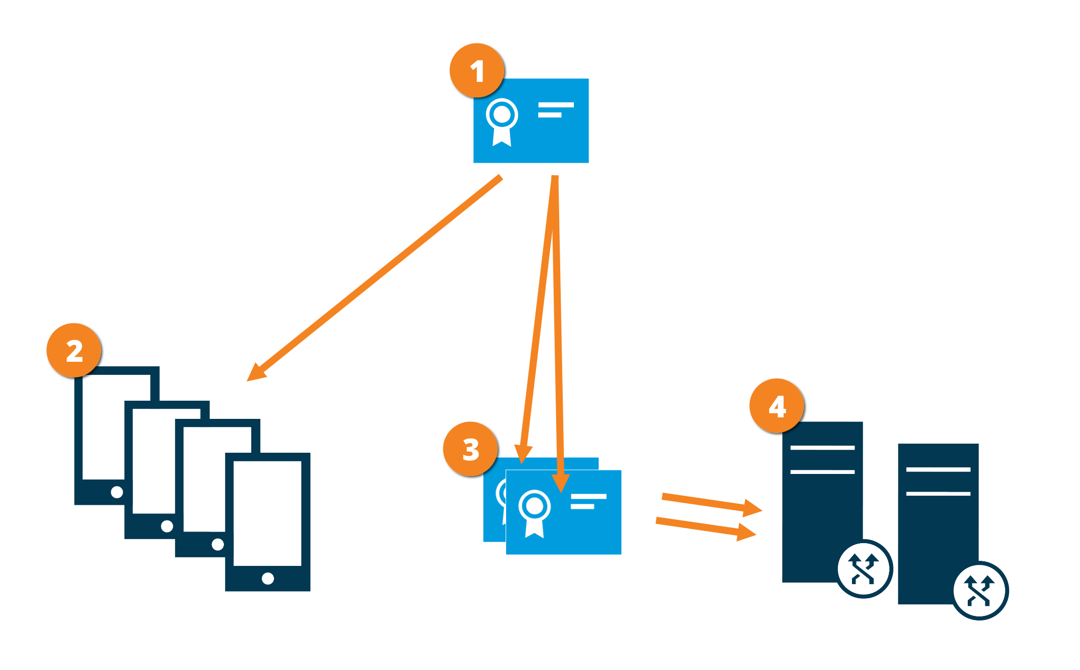

    Mobile server data encryption (explained)
    In XProtect VMS, encryption is enabled or disabled per mobile server. When you enable encryption on a mobile server, you will have the option to use encrypted communication with all clients, services, and integrations that retrieve data streams.
    Certificate distribution for mobile servers
    The graphic illustrates the basic concept of how certificates are signed, trusted, and distributed in XProtect VMS to secure the communication with the mobile server.
    A CA certificate acts as a trusted third party, trusted by both the subject/owner (mobile server) and by the party that verifies the certificate (all clients)
    The CA certificate must be trusted on all clients. In this way clients can verify the validity of the certificates issued by the CA
    The CA certificate is used to establish secure connection between the mobile server and clients and services
    The CA certificate must be installed on the computer on which the mobile server is running
    Requirements for the CA certificate:
    • The mobile server's host name must be included in the certificate, either as subject/owner or in the list of DNS names that the certificate is issued to
    • The certificate must be trusted on all devices that are running services that retrieve data streams from the mobile server
    • The service account that runs the mobile server must have access to the private key of the CA certificate
    Mobile server encryption requirements for clients
    If you do not enable encryption and use an HTTP connection, the push-to-talk feature in XProtect Web Client will not be available.
    If you select a self-signed certificate for the encryption of the mobile server, XProtect Mobile client will not be able to connect with the mobile server.
