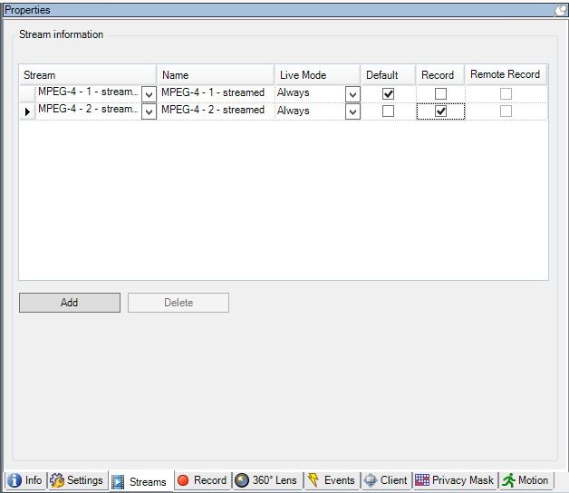

Add a stream
  1. On the Streams tab, click Add. This adds a second stream to the list.
  2. In the Name column, edit the name of the stream. The name appears in XProtect Smart Client.
  3. In the Live Mode column, select when live streaming is needed:
    • Always: the stream runs even if no XProtect Smart Client users request the stream
    • Never: the stream is off. Only use this for recording streams, for example, if you want recordings in high quality and need the bandwidth
    • When needed: the stream starts when a user of XProtect Smart Client requests for it
  4. In the Default column, select which stream is default.
  5. In the Record column, select the check box if you want to record this stream or leave it cleared if you only want to use it for live video.
  6. Click Save.
If you set a stream to Default or Record, the stream is always running independent of the Live Mode setting. Selecting When needed and Always have the same effect in the system and if you select Never, the stream is running, but cannot be viewed live.
If you do not want the streams to run at all unless someone is viewing live video, you can modify the Default Start Feed Rule to start on request with the predefined Live Client Feed Requested event.

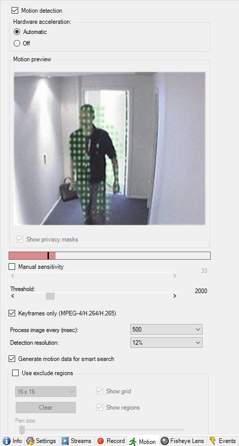

Enable manual sensitivity
The sensitivity setting determines how much each pixel in the image must change before it is regarded as motion.
  1. Select the Motion tab's Manual Sensitivity check box.
  2. Drag the slider to the left for a higher sensitivity level, and to the right for a lower sensitivity level.
    The higher the sensitivity level, the less change is allowed in each pixel before it is regarded as motion.
    The lower the sensitivity level, the more change in each pixel is allowed before it is regarded as motion.
    Pixels in which motion is detected are highlighted in green in the preview image.
  3. Select a slider position in which only detections you consider motion are highlighted.
You can compare and set the exact sensitivity setting between cameras by the number in the right side of the slider.
Specify threshold
The motion detection threshold determines how many pixels in the image must change before it is regarded as motion.
  1. Drag the slider to the left for a higher motion level, and to the right for a lower motion level.
  2. Select a slider position in which only detections that you consider motion are detected.
The black vertical line in the motion indication bar shows the motion detection threshold: When detected motion is above the selected detection threshold level, the bar changes color from green to red, indicating a positive detection.
Motion indication bar: changes color from green to red when above the threshold, indicating a positive motion detection.
Select keyframes settings
Determines if motion detection is done on keyframes only instead of on the entire video stream. Only applies to MPEG-4/H.264/H.265.
Motion detection on keyframes reduces the amount of processing power used to carry out the analysis.
Select Keyframes only (MPEG-4/H.264/H.265) box to do motion detection on keyframes only.
Select image processing interval
You can select how often the system performs the motion detection analysis.
From the Process image every (msec) list:
  • Select the interval. For example, every 1000 milliseconds are once every second. Default value is every 500 milliseconds.
    The interval is applied if the actual frame rate is higher than the interval you set here.
Specify detection resolution
Lets you optimize motion detection performance by analyzing only a selected percentage of the image, for example 25%. By analyzing 25%, only every fourth pixel in the image is analyzed instead of all pixels.
Using optimized detection reduces the amount of processing power used to carry out the analysis, but also means a less accurate motion detection.
  • In the Detection resolution list, select the wanted detection resolution.
Generating motion data for smart search
With Generate motion data for smart search enabled, the system generates motion data for the images used for motion detection. For example, if you select motion detection on keyframes only, the motion data is also produced for keyframes only.
The extra motion data enables the client user, via the smart search function, to quickly search for relevant recordings based on motion in the selected area of the image. The system does not generate motion data within areas covered by permanent privacy masks, but only for areas with liftable privacy masks (see Privacy masking tab (devices)).
Motion detection threshold and exclude regions do not influence the generated motion data.
You specify the default setting of generating smart search data for cameras on the Tools > Options > General tab.
Specify exclude regions
You can exclude motion detection from specific areas of a camera view.
Areas with permanent privacy masks, are also excluded from motion detection. Select the Show privacy masks check box to display them.
Excluding motion detection from specific areas helps you avoid detection of irrelevant motion, for example if the camera covers an area where a tree is swaying in the wind or where cars regularly pass by in the background.
When you use exclude regions with PTZ cameras and you pan-tilt-zoom the camera, the excluded area does not move accordingly because the area is locked to the camera image, and not the object.
  1. To use exclude regions, select the Use exclude regions check box.
    A grid divides the preview image into selectable sections.
  2. To define exclude regions, drag the mouse pointer over the required areas in the preview image while you press the left mouse button. Right mouse button clears a grid section.
You can define as many exclude regions as needed. Excluded regions appear in blue:
The blue exclude areas only appear in the preview image on the Motion tab, not in any other preview images in the Management Client or access clients.
