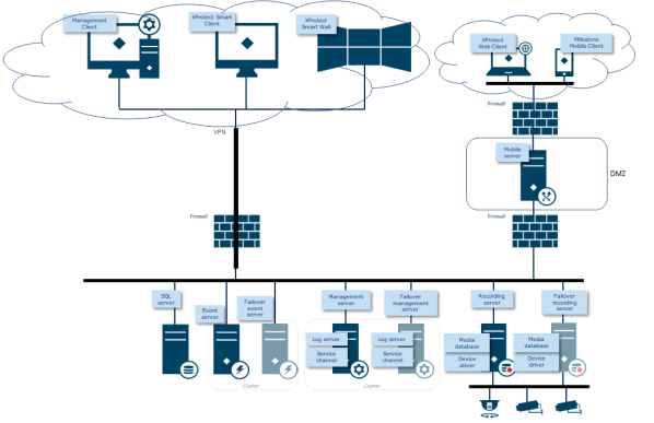

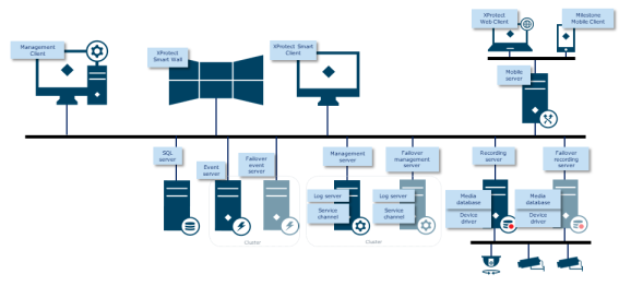

For security, segment the network so there is a client/management network, and camera networks behind the recording servers:
For greater security, put the mobile server in a "demilitarized zone" (DMZ) with one network interface for public access, and one for private communication to other servers, and use VPN encrypted networks for external connections or to increase security for less secure internal networks:
