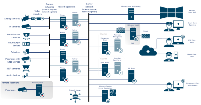

The figure shows an example of a general setup.
