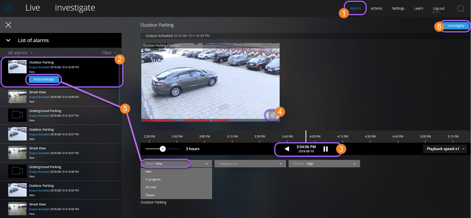

"Camera 3 detected motion at around 4:00 PM and sent me an alarm. It looks like a burglary. I want to see what exactly happened and show the video to my security officer."
On the Alarms tab :
  1. Find and click the alarm that you want to view video for. From the Filter list, you can filter the alarms by states and priorities.
  2. Play the video backward or forward and check when the image that you are seeing was taken .
  3. Start or stop playing audio for the video playback when you play it forward at normal speed (see Playing back audio in video recordings (explained)).
  4. Change the state of the alarm by clicking the Acknowledge button or by selecting another alarm state option from the list .
  5. To save the video for later or share it with others, click Investigate.
  6. Follow the steps in Prepare video export and download.
