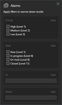

When you apply multiple filters, for example both Priority and State, you filter for results that match all the applied filters.
When you select multiple values within one filter, for example High, Medium, and Low within the Priority filter, you filter for results that match at least one of those values.
