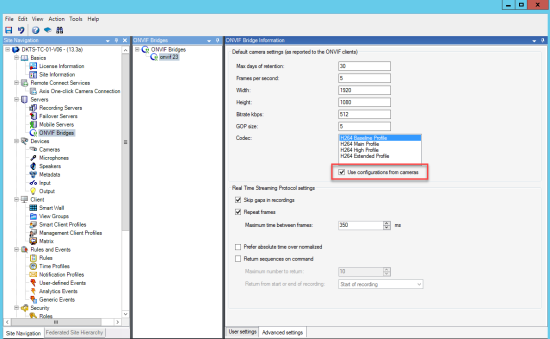

You can use GetRecordingSummary and/or GetMediaAttributes to get the timestamp of the first and the last recording, but you must first enable the Use configurations from cameras setting on the Advanced settings tab on the Milestone ONVIF Bridge plug-in in the XProtect Management Client.
