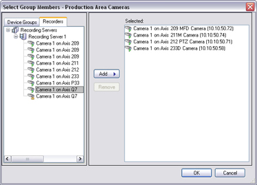

Specify which devices to include in a device group
  1. In the Overview pane, right-click the relevant device group folder.
  2. Select Edit Device Group Members.
  3. In the Select Group Members window, select one of the tabs to locate the device.
    A device can be a member of more than one device group.
  4. Select the devices you want to include, and click Add or double-click the device:
  5. Click OK.
  6. If you exceed the limit of 400 devices in one group, you can add device groups as subgroups under other device groups:
