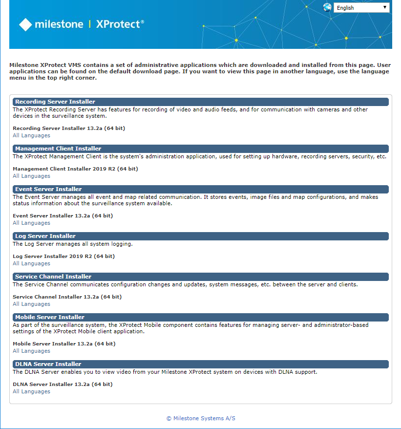

  • One web page is targeted at administrators, enabling them to download and install key system components. Most often the web page is automatically loaded at the end of the management server installation and the default content is displayed. On the management server, you can access the web page from Windows' Start menu, select Programs > Milestone > Administrative Installation Page. Otherwise you can enter the URL:
    http://[management server address]:[port]/installation/admin/
    [management server address] is the IP address or host name of the management server, and [port] is the port number which you have configured IIS to use on the management server.

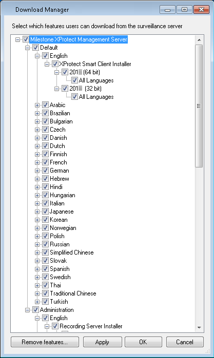

  • The first level: Refers to your XProtect product
  • The second level: Refers to the two targeted versions of the web page. Default refers to the web page version viewed by end users. Administration refers to the web page version viewed by system administrators
  • The third level: Refers to the languages in which the web page is available
  • The fourth level: Refers to the components which are - or can be made - available to users
  • The fifth level: Refers to particular versions of each component, which are - or can be made - available to users
  • The sixth level: Refers to the language versions of the components which are - or can be made - available to users
The fact that only standard components are initially available - and only in the same language version as the system itself - helps reduce installation time and save space on the server. There is no need to have a component or language version available on the server if nobody uses it.
You can make more components or languages available as required and you can hide or remove unwanted components or languages.

When you have installed new components, they are by default selected in the Download Manager and are immediately available to users via the web page. You can always show or hide features on the web page by selecting or clearing check boxes in the Download Manager's tree structure.
You can change the sequence in which components are displayed on the web page. In the Download Manager's tree structure, drag component items and drop them at the required position.

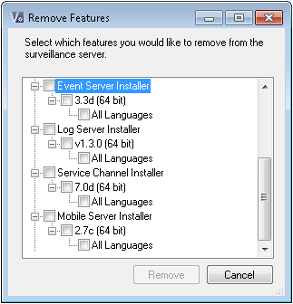

  • Hide components from the web page by clearing check boxes in the Download Manager's tree structure. The components are still installed on the management server, and by selecting check boxes in the Download Manager's tree structure you can quickly make the components available again
  • Remove the installation of components on the management server. The components disappear from the Download Manager, but installation files for the components are kept at C:\Program Files (x86)\Milestone\XProtect Download Manager, so you can re-install them later if required
    1. In the Download Manager, click Remove features.
    2. In the Remove Features window, select the feature(s) you want to remove.
    3. Click OK and Yes.
