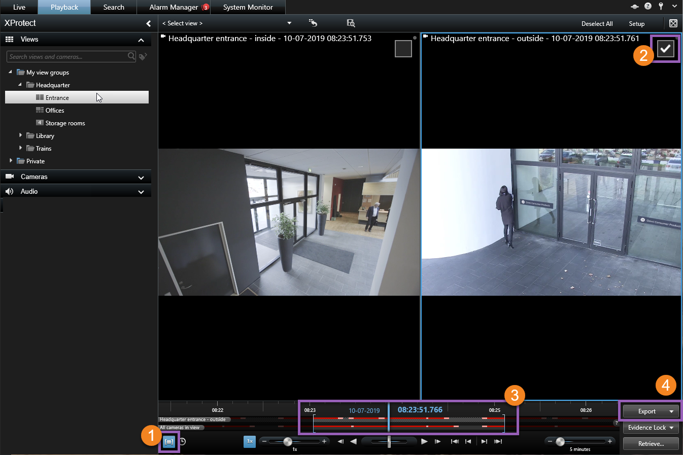

Start the export on the Playback tab
  1. Click to turn on time selection mode .
  2. Select the cameras you want to include in the export .
  3. Drag the square brackets to select a start and end time for the export .
  4. Click Export > Export to open the export window .

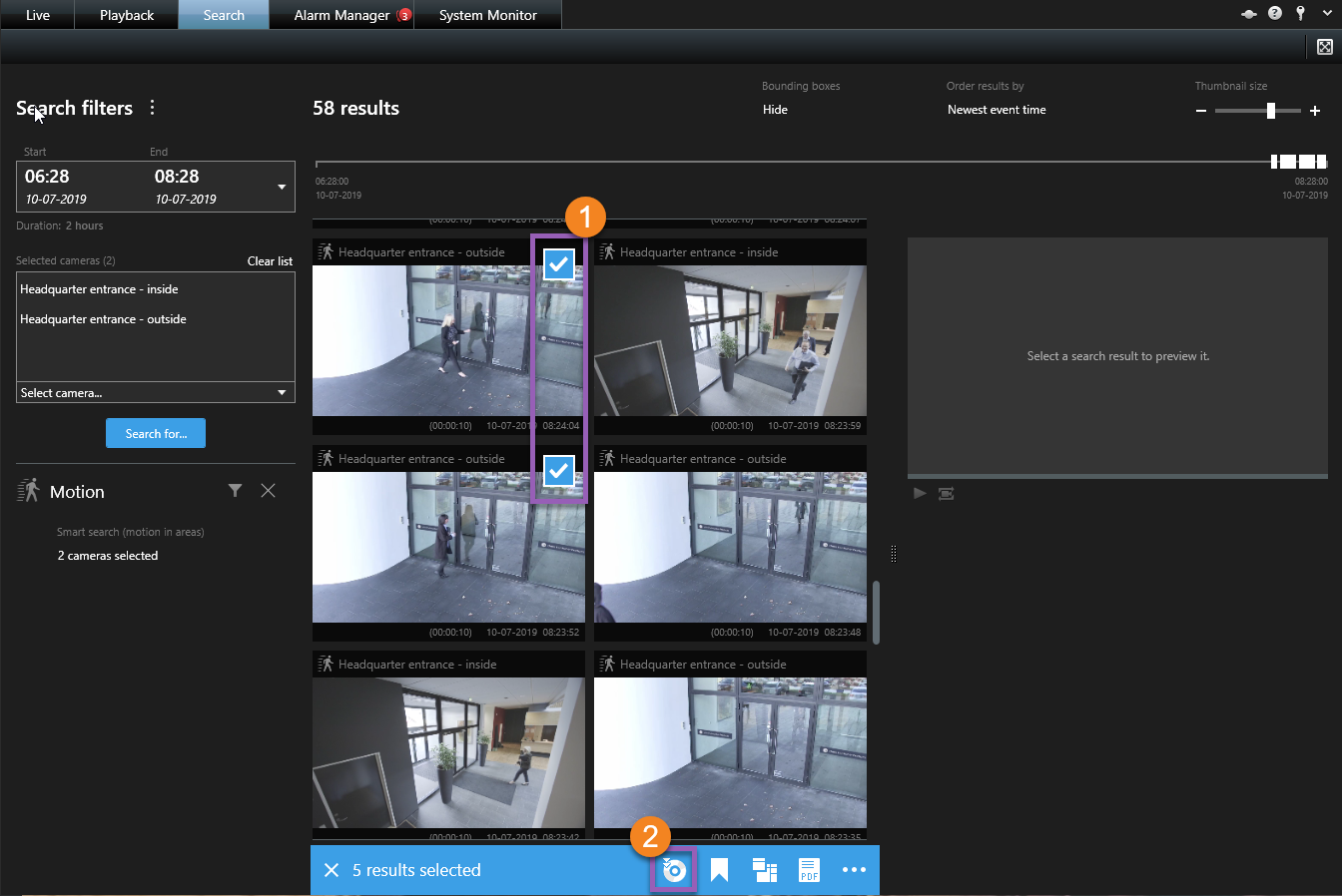

Start the export on the Search tab
  1. For each search result you want to export, hover over it and select the blue check box that appears .
  2. In the action bar, select the export icon .

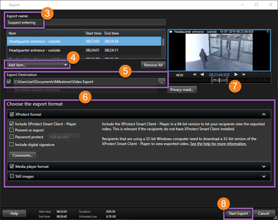

Specify the export settings
  1. Enter a name for the export file .
  2. If needed, add more cameras .
  3. Specify the export destination .
  4. Select a format for the export .
  5. To adjust the start and end time, use the square brackets .
  6. Click Start Export to start the export .
For details about the export settings, see Export settings.
