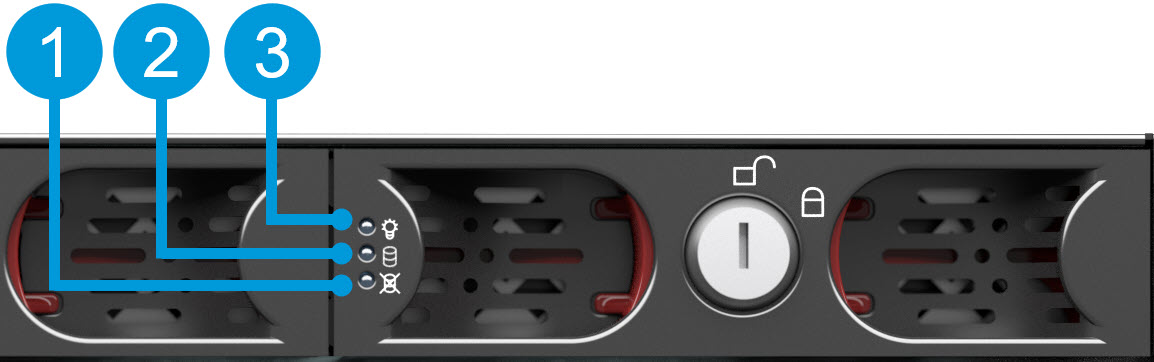

Find the data hard drive tray with a red LED status indicator (1) on the front of your unit. Red shows that there is a hard drive failure and that the hard drive must be replaced.
| LED status indicators | LED colors |
| 1. Data hard drive failure | Red |
| 2. Data hard drive activity | Flashing green |
| 3. Data hard drive power | Blue means ON |

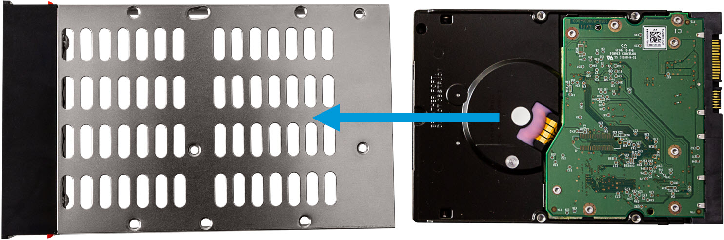

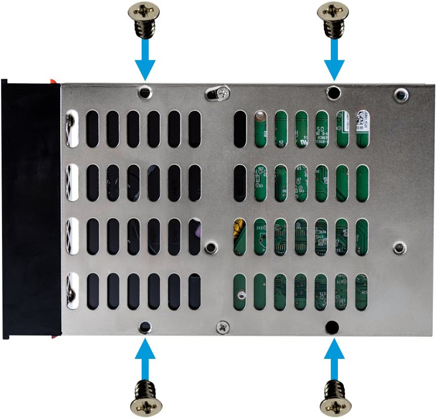

Remove the screws to pull the faulty hard drive out of the tray.
Locate the replacement hard drive and slide the hard drive into the tray.
Make sure that your hard drives performance is approved for use with the Milestone Husky products. For information on performance approved hard drives, go to the Milestone Husky support and information page (https://www.milestonesys.com/HuskyX8-support/).
- Use the screws to fasten the hard drive to the tray.

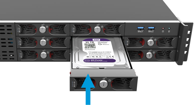

Slide the tray into the empty hard drive bay. Pinch the buttons inside the tray before you insert the tray.
- Lock the trays to protect your hard drives from unauthorized removal.

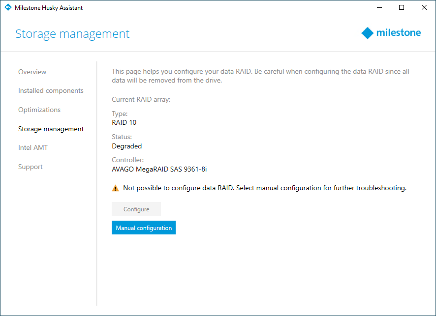

To make the hard drive that you just replaced available for the RAID array, rebuild the RAID:
Click Manual configuration to open MegaRAID Storage Manager.

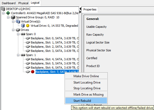

Select the Logical tab.
Right-click the degraded hard drive with a red mark and select Start Rebuild. A warning appears. Select Confirm and click Yes to start the RAID rebuild.
