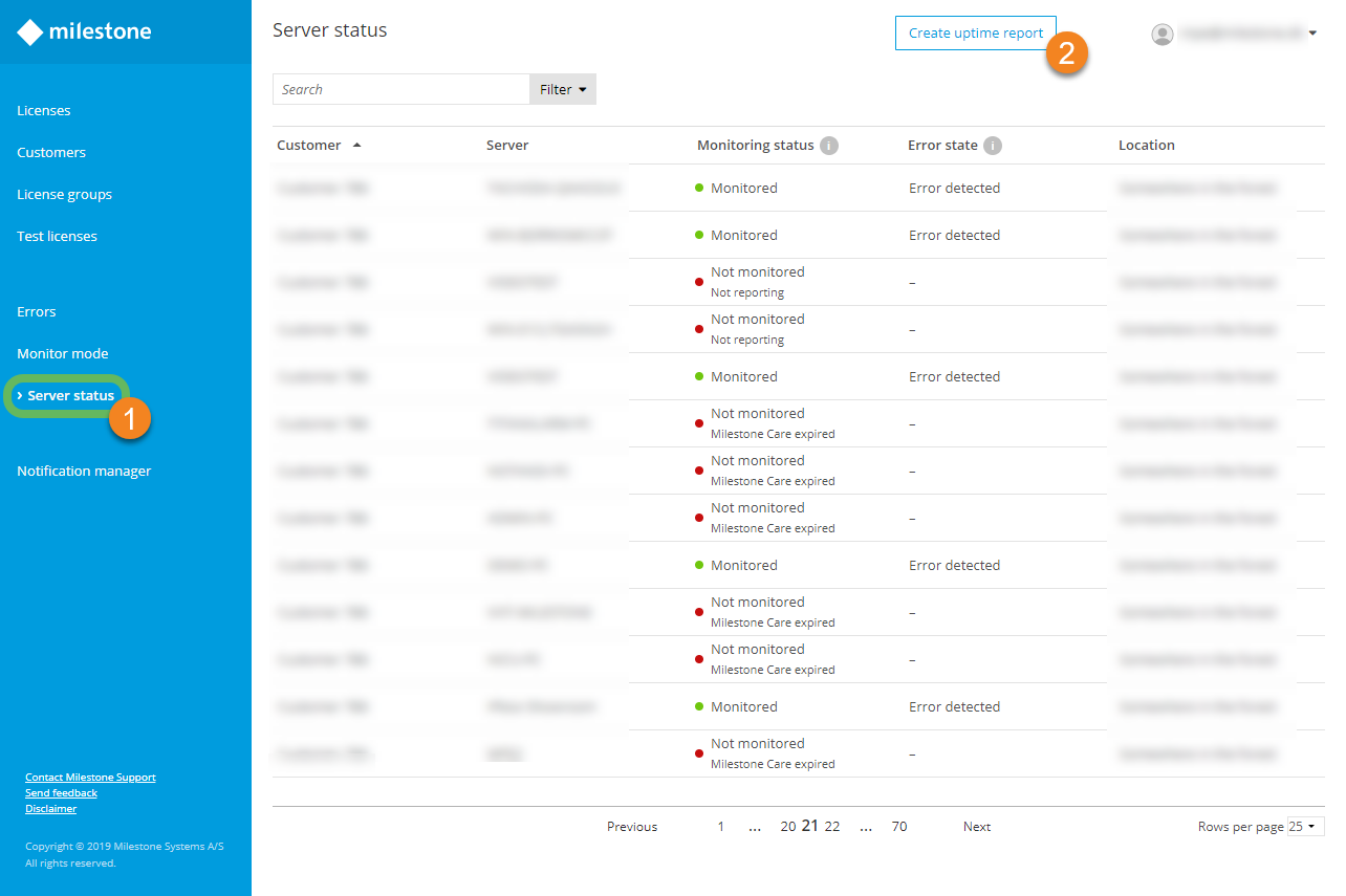

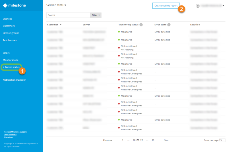

  1. In the main menu, select Server status , and then select Create uptime report .

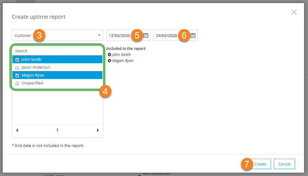

  2. In the Create uptime report dialog box, select a filter for the report :
    • Customer - The report contains information about all servers that are associated with the selected customers, independent of licenses
    • License - The report contains information about all servers, categorized by licenses
    • Location - The report contains information about all servers at specific locations independent of customers and licenses
    • Server - The report contains information about specific servers independent of customers, licenses, or locations
  3. Use the search field to refine the list of items to select from, and select the items that you want to include in the report .
  4. Specify a start date and end date for the report.
  5. Select Create to download the report as a PDF file.
