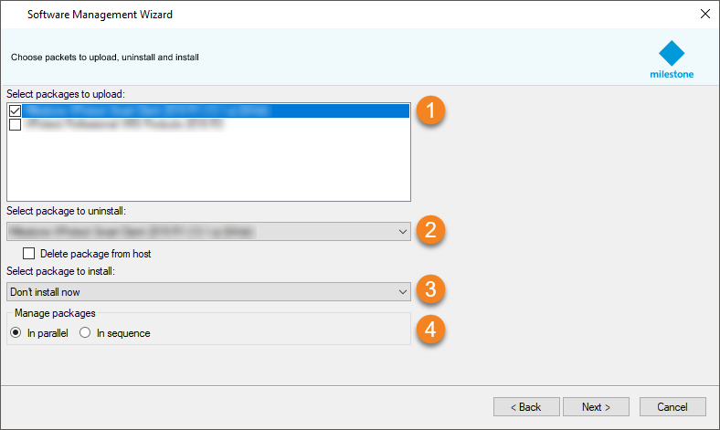

    With the Software Management Wizard you can upload, uninstall and/or install software packages easily. The wizard lets you do everything in one run, or if you prefer, upload first, then uninstall and finally install packages. Or you can do any combination hereof by simply running the wizard as many times as needed. However, provided a run of the wizard contains more than one task, the task sequence is always the same, first upload, then uninstall and finally install.
    The wizard interface is divided into the following areas:
    • 1 - Upload - lets you select the installer files to upload to the selected remote servers. You can select one or more files, or leave the check box empty. An installer file must be uploaded before it can be installed or uninstalled.
    • 2 - Uninstall - lets you select the software to uninstall, or leave the field empty. Selecting Delete package from host will furthermore remove the installer file after the product has been uninstalled (see Important information) (at that point, the installer file is no longer needed).
    • 3 - Install - lets you select software to install, or leave the field empty.
    • 4 - Manage - lets you select how to schedule the upload, uninstallation and installation tasks on the remote servers. Select either In parallel or In sequence. If the tasks are scheduled in parallel, the task sequence will occur simultaneously on all the remote computers, and if the tasks are scheduled sequentially, the servers will be updated one at the time.
    If you update in sequence, note that it will take somewhat longer (see Important information) than updating in parallel. However, updating in sequence might be desirable if network resources are limited or for testing the result of the process in small scale before rolling it out wide scale.

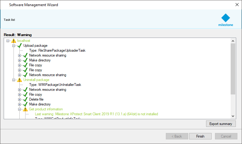

  9. Results for the entire update process are shown. Expand to view details.
    To export results to other programs for further editing/distribution, click Export Summary. When done, click Finish.
