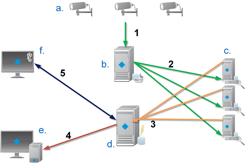

XProtect LPR system architecture
Basic data flow:
  1. LPR cameras (a) send video to the recording server (b).
  2. The recording server sends video to the LPR servers (c) to recognize license plates by comparing them with the license plate characteristics in the installed country modules.
  3. LPR servers send recognitions to the event server (d) to match with the license plate match lists.
  4. The event server sends events and alarms to XProtect Smart Client (e) when there is a match.
  5. The system administrator manages the entire LPR configuration, for example, setting up events, alarms, and lists from the Management Client (f).
